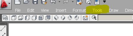

Dadgad Posted January 19, 2013 Posted January 19, 2013 Should all those options fail you, click TOOLS on your MENU BAR > TOOLBARS > AUTOCAD to access all your old toolbars, enter RIBBONCLOSE at the commandline and hit ENTER, then go ahead and set up your workspace and SAVE it once you have it configured how you like it. Define it as your space, give it a name, check out the other available options in the workspace dialog box. Quote

Dadgad Posted January 20, 2013 Posted January 20, 2013 If your MENU BAR is not showing, you click on the little black arrow at the right end of your QUICK ACCESS TOOLBAR (above the word TOOLS in my previous image) and click SHOW MENU BAR, I suspect that you will see the TOOLS menu option as highlighted in my earlier image. If you do, I think you are home free. As previously suggested expand that TOOLS drop down list and select TOOLBARS > Autocad. Also as suggested by Organic, click the GEAR icon in the lower right corner of your screen to see the WORKSPACE selection options and you will probably see AUTOCAD CLASSIC as one option. I have never used MEP, but I imagine that you will find these options, hope so. It seems unlikely to me that it would have been deleted from one version, and still be available in Vanilla Autocad 2013, where I, like ReMark also have it. Quote
