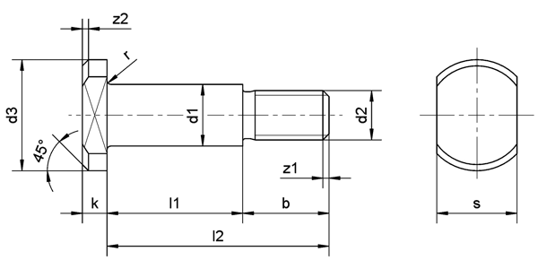

ZL45 Posted January 22, 2013 Posted January 22, 2013 Edit: Fastener size. Can't find a way to change that. Our teacher left us with a problem and I can't really understand this. I'm reading through the book and there's basically little to no "how to do" or examples I can follow. We have to do a 2D drawing and need some help reading the problem. It's a Flathead cap screw - 3/8 - 16 UNC 2A x 2.0 lg 1.0 grip So far I know that 3/8(.375") is the major diameter, 16 is the threads per inch, 2A is the average with external thread, and 2.0 is the length. I pretty much don't know how to put it into a drawing.. Can anyone help? Thanks in advance. Quote

ZL45 Posted January 22, 2013 Author Posted January 22, 2013 When I wrote no answer or picture I meant a brief explanation of the problem using the formulas and chart(s) so I can understand these problems clearly. If I do understand it, I will post with a pic to see if I did anything wrong. For my example, d1 would be my major diameter, correct? If so, how do I calculate to get the measurement of the head? Quote
ReMark Posted January 22, 2013 Posted January 22, 2013 Is that an image of a flathead cap screw? Quote
ZL45 Posted January 22, 2013 Author Posted January 22, 2013 No but it's only used as my example for the question. Quote
ReMark Posted January 22, 2013 Posted January 22, 2013 I'm not a machinist but isn't each type of screw or bolt measured a little differently? What applies to one type of screw may not apply to another. I don't think you have the right diagram to go with the screw that you mentioned in your first post. Quote
Bill Tillman Posted January 22, 2013 Posted January 22, 2013 When I wrote no answer or picture I meant a brief explanation of the problem using the formulas and chart(s) so I can understand these problems clearly. If I do understand it, I will post with a pic to see if I did anything wrong. For my example, d1 would be my major diameter, correct? If so, how do I calculate to get the measurement of the head? [ATTACH=CONFIG]39770[/ATTACH] So do you have a chart on this fastener? Or do you need to find one in order to size the head? I don't see many fasteners like this too often so I'd have to do some research myself. This is a flatheat cap screw...so I think he's got something more customized going on here: Quote
ZL45 Posted January 22, 2013 Author Posted January 22, 2013 Couldn't find a good size but this will do. I understand that the diameter would be 3/8 (.375), how would I be able to measure the head of the screw? Quote
ZL45 Posted January 22, 2013 Author Posted January 22, 2013 So do you have a chart on this fastener? Or do you need to find one in order to size the head? I don't see many fasteners like this too often so I'd have to do some research myself. This is a flatheat cap screw...so I think he's got something more customized going on here: [ATTACH=CONFIG]39772[/ATTACH] This. So the head size would be on the chart? Quote

ReMark Posted January 22, 2013 Posted January 22, 2013 A chart. http://www.fairburyfastener.com/xdims_shcs_flat.htm And another. http://www.smithfast.com/msflathead.html And one more for all you metric users out there. http://viewmold.com/Products/Unbrako-Screw/Metric%20Flat%20Head%20Cap%20Screws.pdf Quote

Bill Tillman Posted January 22, 2013 Posted January 22, 2013 Yeah, JD came of of the birth canal with a slide rule in one hand and a compass in the other asking, "OK who's in charge here?" The second schematic the OP posted looks more like the FH cap screws I'm used to seeing around. As for the diamter of the head, that I too would have to look up in a chart. The first schematic has some machining on the head which would make you think it fits into something to keep the bolt from spinning when the nut is torqued. There a literally thousands of types of fateners, and we haven't even started talking about thread types yet. 3/8-16 is one thing but then there's type "A", type "AB", and the list goes on and on. Just be sure you've got what your instructor is wanting to see. We'd hate to see you turn in something and then have it rejected. Quote
