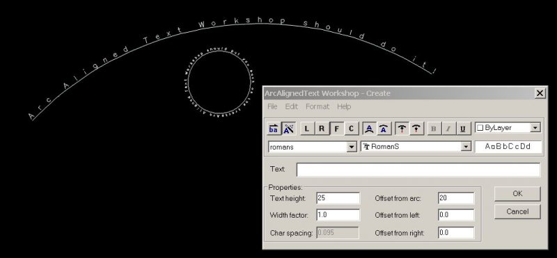

Dadgad
Welcome to CADTutor. :)
Have you tried the EXPRESS TOOL called Arc-Aligned Text?
It should solve any problems you are having.

JD Mather
When using the arc aligned text it might be useful to break up your circle into arcs for more control.

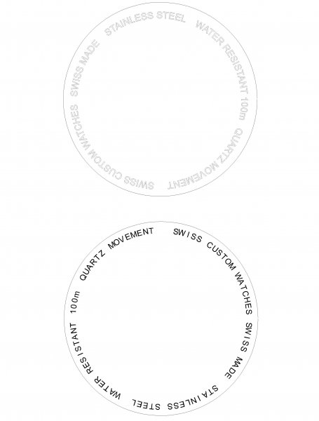

ArqCastro
I did, but it doesn't work properly... I need to write a full circle (for watches I redraw to a Switerzerland company) and it just doesn't come out right... some letters get cluttered, pulling them apart only makes it look worse... (on the bottom image see how SWISS is...)Texto em Circulo DO COREL-Model.jpg
Eventually I made it on Corel (on top of the image, unfilled but there's an option to make it fill on import) and them imported it back to Autocad but... I really wanted to do everything here... but... arc aligned text is not the answer! :-(
And yes, I cuted a small portio of the circle so the AAT command could work.

ArqCastro
SLW210, If you use the font bigger you'll see the problem, especially between the S, the W and the I letters, try it ;)

ArqCastro
I will give it a look as work load allows. :thumbsup:
No worries, no rush, with the help of Corel I fixed my problem, now is just a matter of finding an alternative inside AutoCAD!
