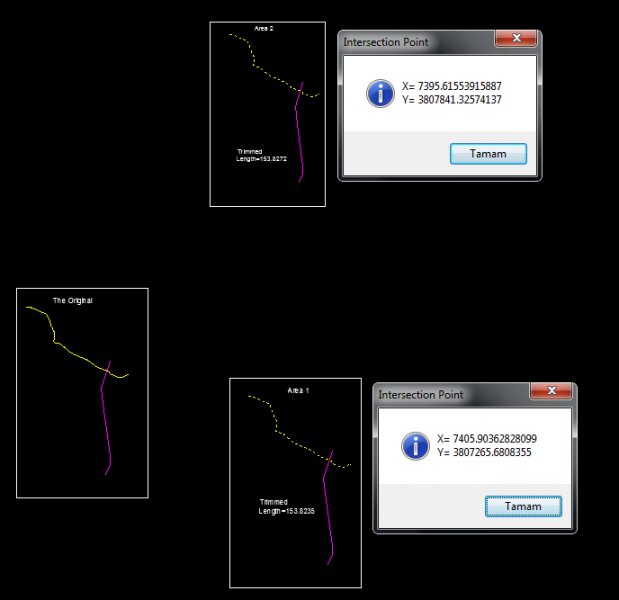

Hi, I'm Acad 2010 user. The attached file, the problem seems. I'm having trouble polyline you change the location of objects. When I move to area 1. Polyline inside area 1 the trimmed length is correct. But When I move to area 2 Polyline inside area 2 the trimmed length is incorrect. Remains a small piece of magenta polyline.
Is UCS values ​​is bigger is going on?
However, when you have made a query. Acad finds 2 intersection point in area 2, incorrect. And Acad finds 1 intersection point in area 1,correct.
I do not understand the problem. Thanks for your help.
(All Z values ​​to zero. All objects is polyline)

Hi eldon thanks for help.
But there's a problem. I got to the intersection point. Point with VBA to read. Very points. But it shows an incorrect result. I'm not sure this is the place to VBA forum? VBA does not work why? Do you have one you know? Thanks in advance. The same two points. But the result is different from 2. Very stuck. I need to find.

Give different results in the same code area 1. Area 2 also give different results.
Thanks for help.

Hi Tyke. I told a more descriptive way. Waiting for assistance. Thanks in advance.
Objects gives an error when I move into the area 2. Deceive me. (UCS) coordinates is making the problem be?

Tyke
Hi 4gokay,
Now I see the problem and it can possibly be linked with your trim problem. I see the problem as being that you have a node on your yellow polyline that is 0.039 mm from the intersection point of the two lines. The second set of coordinates are the coordinates of the node. If I move this node so it is 0.060 mm from the intersection point then your code returns only one intersection point. It is as though there is a search radius of approximately 0.05 mm and any line segments within that radius will return an intersection point with the other polyline. What I don't understand is that in the other 'areas' which are identical to area 1 do not return 2 intersections. I copied the 'original area' and that returned 2 intersectio points. I Googled and found lots of reported problems with the IntersectWith method, so it could well be a bug in VBA.
Unfortunately I see no fix for the problem. Sorry. Let's see if anybody else can help.

BlackBox
Curiously... It appears as though when one copies the line work 'up' two coordinates of intersection are returned, yet 'down' only one.
To test my theory, try copying Area 1 between Area 1 and Area 2 in the Y, and between the Areas and the white line work at right and two coordinates are returned.
However, were you to move the resultant copy of Area 1 down in the Y, so that it now is located between the original Area 1 and the bottom of the white line work at right, then one coordinate is returned.

Tyke
I can confirm what you say RenderMan. But why? That is what I don't understand. But if the OP is working only with original polylines then the problem should not arise as it seems to be just in certain copied objects.
In area 1, if you draw over the two polylines with two new polylines and then delete the original ones, you still get two intersection points returned. That busts the theory above. I have no explanation!

4gokay
Hi Tyke.
I would not be the solution to the problem. But to me the right part. Examine the better. Problem coordinate systems. I think. I wonder if digits may be coming fortunes? When the problem will not come close to the coordinates 0,0,0. When away from problems and errors. Greetings.
