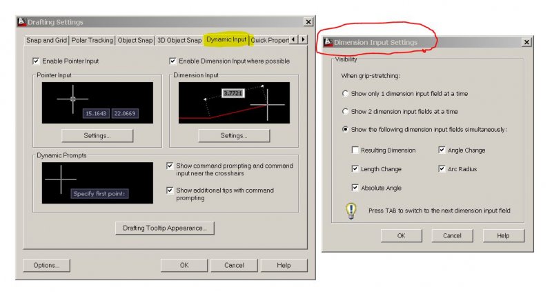

So when i would select a line, hover over one of the endpoints, the length and angle would be shown, as a quick dimension. for some reason that has stopped, all it does now if i select the line, hover over an endpoint the only thing it says is stretch, or lengthen.

Your DYNAMIC INPUT has been turned off.
You may toggle it back on with F12, or by clicking on the circled icon in the image.
There are a number of ways this function can be customized, check out the DIMENSION INPUT dialog image, and set it however you prefer it.
If you want to use the old array dialog box then use the ARRAYCLASSIC command.
If you edit the alias or the macro for the array icon you can easily set your system
to default to the old box.

Oh wow. thanks, yeah i thought it might be the dynamic input, but i didnt remember there were settings that you could switch. and also thanks for the info on array. i missed that, ill have to try that next time. sadly i only use autocad at school, so every time i re-open, its always back to factory settings.
If you always sit at the same workstation you could save a PROFILE and a WORKSPACE configuration,
which would enable you to return to those settings, after the program booted.

There is a difference between the DYNAMIC INPUT fields and the HOVER GRIP menus.
Lengthening means along the existing axis defined by the starting and ending points, could be in either direction, and starting from either of the endpoint grips.
Stretching is not so constrained.
A stretched object may remain the same length as previously, but with a vector change.
