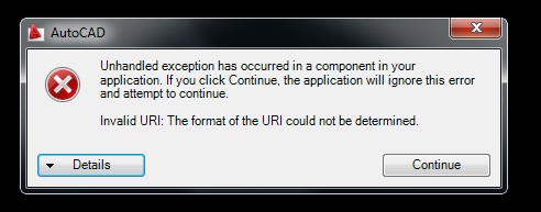

Hello,
Two of our engineers here use CAD 2009 for basic drafting purposes. One of them keeps getting an error message soon as CAD finishes starting up. Also, CAD periodically crashes. This has been happening over the past few days. The other engineer has not had a problem. Recently, we upgraded him with a new PC (used from one of the other draftsmen). My next course of action is to try a reinstall.
Thoughts?
You might try disabling the InfoCenter also referred to as the CommCenter. Links to a routine that automates the process have been posted recently. Try "InfoCenter" as your search criteria.
Fixed! Thanks!
