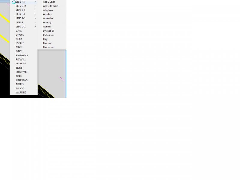

BIGAL Posted February 15, 2013 Posted February 15, 2013 If you make a menu you can have sub menu's -> menu The command would be what ever you want within LT's capbility [->LISP1 A-B] [Add 2 Level]text [->Add-pits-drain]^C^Cpline [Allbylayer]^C^Clayer ... ... ... [<-.....] [<-....] Quote
ankurpraja Posted February 17, 2013 Author Posted February 17, 2013 Thanks Bigal for your reply. Actually i don't know anything about LISP so i did not understood anything you said. Quote
BIGAL Posted February 18, 2013 Posted February 18, 2013 The example is for a drop down menu the 1st option would be beam,column,rafter picking one would open a second sub menu beam PFB, UB, C, Z then even further Beam UB 200ub25,250ub37 etc Quote
