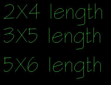

Can any one help me to modify the below pasted codes? since that lisp which i got from other site...but i would like to modify as per my requirement...I am not familiar with lisp programs...pls some one help me..
currently this lisp will add numbers from first numbers only in each text selection (ie. 2, 3)...But i would like to change as below..
As per snap shot...Total = ((2*4)+(3*5)+(5*6)) = 53

That's a very specific set of circumstances.
Are the values always the 1st and 3rd characters
Are they always numeric values
etc...
-David
Thanks David Bethel...
Yes...1st & 3rd characters only...but 3rd character will be one or two digits (Ex. 33, 43)
Yes..all are always Numeric values only
Try this
(defun c:add (/ cval cval1 index l ss strend val)
 (setq ss    (ssget '(( 0 . "text")))
l     (sslength ss)
index 0
val   0)
 (repeat l
   (setq strend (cdr(assoc 1 (entget(ssname ss index))))
   	  cval   (atoi (substr strend 3))
  cval1  (atoi strend)
   	  val    (+ val (* cval cval1))
         index  (+ 1 index)))
 (alert (strcat "total = " (rtos val 2 0))))

This will allow for any number of digits either side of the 'x':
(defun c:addit ( / a b c d )
   (if (setq a (ssget '((0 . "TEXT") (1 . "#*[xX]#*"))))
       (repeat (setq b (sslength a))
           (setq c (strcase (cdr (assoc 1 (entget (ssname a (setq b (1- b)))))))
                 d (cons (* (atoi c) (atoi (substr c (+ 2 (vl-string-position 88 c))))) d)
   (print (apply '+ d))
Thanks paulmcz, David Bethel & Lee Mac.. Its working fine...thanks a lot..
