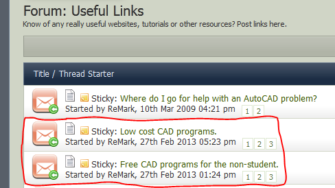

VanD Posted August 20, 2014 Posted August 20, 2014 Hi ReMark, I've been trying to find the thread posts you mentioned in this post and can't locate either of them or the Useful Links Forum - I am not familiar with this site yet though and maybe I just don't know where to look? Quote
ReMark Posted August 20, 2014 Posted August 20, 2014 Forum > Resources > Useful Links Seek and ye shall find. Quote
