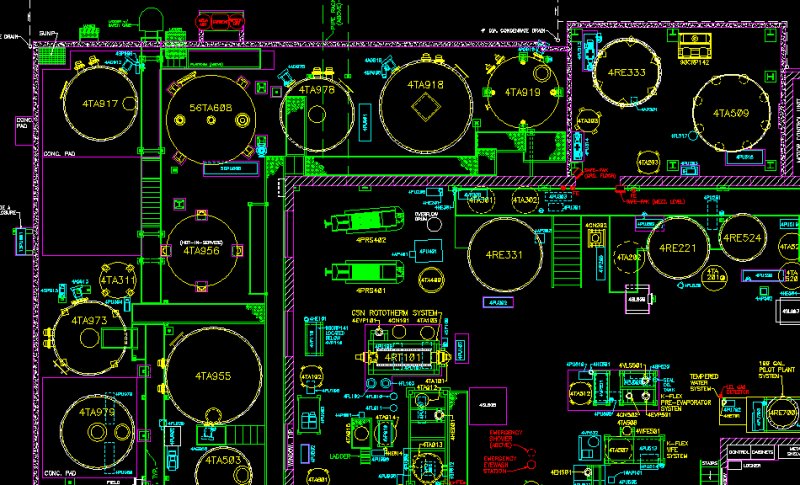

ReMark Posted March 8, 2013 Posted March 8, 2013 Re: Heller PFH drawing. Not much in the way of detail there. You should see what one of our process building layouts looks like. I work at a small chemical plant. What type of plant do you work at? Quote

nmgmarques Posted March 8, 2013 Author Posted March 8, 2013 We build refrigeration compressors. The building has 4 halls. This portion is from hall 2, where we have our CNC mills, conventional machines and such. I'd love to see a sample of your work. My goal is to start changing some of the hundreds of outdated drawings and start giving them some detail and make them look... well, at lack of a better word... more professional. Quote

ReMark Posted March 8, 2013 Posted March 8, 2013 This is one corner of a process building. Tanks, pumps, mezzanines, stairs, building columns, etc. are all included in every such building layout. We have four process buildings and five tank farms. The tank farm layouts are just as detailed. Quote

nmgmarques Posted March 8, 2013 Author Posted March 8, 2013 Jesus H Christ! There's not a hope in hell I can make anything as good as that. Not at my current level. Maybe some way down the line. For now, it's mostly lines and rectangles for me Thanks for showing me that. Gives me something to aim for. Good stuff. Quote
