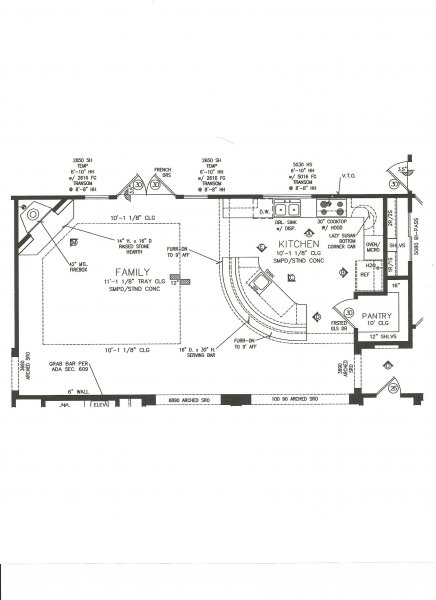

I have attached an example of my problem below. When I am working with the plan, I use the leader command to create a leader (LE), same as always.
My leaders are set to be closed arrows, always use the same dim style.
I insert the leaders and it looks perfect. But the problem is when I shut down the drawing - the next time I open it the leaders are ticks.
It's a little tough to see, but all of the leaders are architectural ticks.
Example
Sorry, can't help with just an image. I should have said to post the .dwg file.
Are there any dimstyle overrides showing up when you check your dimstyle?
