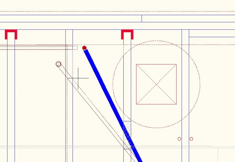

jiggly_jelloo Posted March 22, 2013 Posted March 22, 2013 I have been having an issue with my hatches, especially when I use solid. I always make them associative but when I have to move an object using stretch, the hatch does not come along with it. When I hatch an item I generally use the "pick points" option. Do I need to be using select objects? Or is there something else that I am missing? Thank you Quote

jiggly_jelloo Posted March 22, 2013 Author Posted March 22, 2013 Here is what happens when I try to stretch it Quote

rkent Posted March 23, 2013 Posted March 23, 2013 Turn on and thaw all layers as a test, now try stretching the hatch. Quote
jiggly_jelloo Posted March 25, 2013 Author Posted March 25, 2013 Here is a section of the drawing. I re-did the hatch this morning and I still get the same result Drawing2.dwg Quote
ReMark Posted March 25, 2013 Posted March 25, 2013 Start a new drawing. Draw a rectangle. Fill it with a solid hatch. Make sure it is "associative". Stretch it. What happens? Who created the drawing and what program was used originally? Quote
jiggly_jelloo Posted March 25, 2013 Author Posted March 25, 2013 It is fine in a new drawing. We tend to use old drawings as the base or new drawings since the structure etc is exactly the same and then we just have to modify the interior partitions. When I looked into the drawing properties it says the drawing was originally created in 2008, so I am not sure what version of autocad would have been used back then. I am not sure if there is a way to tell what version it was originally created in. I was trying to stretch another hatch as well (denoting ductwork) and it did not stretch and when I select hatch edit, the 'associative' box is not checked although I know that I selected it when originally creating it. I tried drawing a rectangle and a few other shapes within the same drawing and hatching and stretching those and they worked fine. Quote
ReMark Posted March 25, 2013 Posted March 25, 2013 You can have your sample back now. That is one of the weirdest drawings I've seen. Did you know that your geometry is off on that pipe with the solid hatch. Who drew it? Drawing2_ReMark.dwg Quote

ReMark Posted March 25, 2013 Posted March 25, 2013 Did you open the drawing I posted? I fixed your problem. Quote
jiggly_jelloo Posted March 27, 2013 Author Posted March 27, 2013 Did you open the drawing I posted? I fixed your problem. Thank you. I did finally get to open and look at it. Can you tell me how you fixed it? I have several drawings that have the same issue and it is annoying that I have to rehatch something everytime I modify it. I can't wait until we go 3D....my life will get so much easier!! (once I learn the new software of course ) Quote
