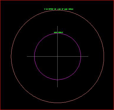

i want to draw one circle with dimension in meter + some more circle of 1/2 dia of same circle + 1/4 dia of same + 1/3 dia of same + 1/6 dia of same this all other circle are dimension according to the 1st circle which should be in meter.
for Example :
Dia of Circle is - 60 m.
than 1 st circle should be offset of 60m dia circle calculating 1/2 dia of the same circle and it should be in diffrent colour or layer like this all other circle should have same offset accordingly

something I just realized after reading your post again:
are the concentric circles to go outward for the first circle or inward?
going inward use the code above
going outward would be this instead:
    half (+ r (/ r 2.0))     third (+ r (/ r 3.0))     quarter (+ r (/ r 4.0))     sixth (+ r (/ r 6.0))
This is the way i am looking for this is just example of 1/2dia from the main tank.
I understand what you mean now. All the code I posted was intended for the command line. You are looking for something to load and run. Save the code to an external file and load it into your drawing. Draw your tank circle and type the command TEST in the command line. It should prompt you to select an entity (in this case the circle representing the tank).
