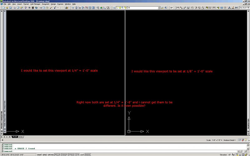

kwortman Posted November 17, 2008 Share Posted November 17, 2008 I have searched the forum and have not found any threads on this subject. My question is: Is there a way to get different scale factors within multiple model space viewports? For example, one viewport will be set at 1/8" scale and another viewport will be set at 1/4" scale. Quote Link to comment Share on other sites More sharing options...

kwortman Posted November 17, 2008 Author Share Posted November 17, 2008 For some reason you can't select the different viewport frames when they are created in modelspace. It would be nice if you could. Quote Link to comment Share on other sites More sharing options...

wannabe Posted November 17, 2008 Share Posted November 17, 2008 Your talking about changing views within modelspace, not changing the scale of viewports created in paperspace. The only way to do this is when you are in a view use the zomm scale method. For example in one of your views just hit z for zoom s for scale and 1/48xp for example if you want it to be 1/4" That will affect all of the objects in model space though. I think he selectively wants certain models at different scales within model space - but drawn at one to one. Sounds similar to Microstation to me. Quote Link to comment Share on other sites More sharing options...

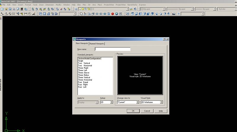

jaylo23 Posted November 17, 2008 Share Posted November 17, 2008 If you use the vports command you are giving the option of having up to 4 different views within model space instead of one view. You could then set any of these up at whatever scale one would like without affecting the others. It might be that i am not truly understanding the question so i apologize if this is the case. Quote Link to comment Share on other sites More sharing options...

kwortman Posted November 17, 2008 Author Share Posted November 17, 2008 Wannabe is right, that is what I am looking to do, except at any scale. Here is a screen shot of what I would like to do. If it is possible. Thanks for all of the replies. Quote Link to comment Share on other sites More sharing options...

wannabe Posted November 17, 2008 Share Posted November 17, 2008 Sorry jaylo was right. You will need to use the zoom factor in each viewport in model space to set the scale. eg if your in millimetres 1:1 = 1xp i think. Quote Link to comment Share on other sites More sharing options...

jaylo23 Posted November 17, 2008 Share Posted November 17, 2008 Hey wannabe, do you not get this dialogue box when you type "vports" at the command line in modelspace? Sorry for the poor image quality. Quote Link to comment Share on other sites More sharing options...
wannabe Posted November 17, 2008 Share Posted November 17, 2008 Yeah yeah, mate. I've never tried to set model space up for multi viewports. Paperspace is all I need really for my line of work and I assumed you could not have them in model space. Glad I looked at this thread. Quote Link to comment Share on other sites More sharing options...
EMS_0525 Posted November 17, 2008 Share Posted November 17, 2008 i use a min. of 3 viewports in model space to do 3d work. and each viewport can be broken down into more viewports too.. so essentially you could have as many viewports as you want Quote Link to comment Share on other sites More sharing options...
