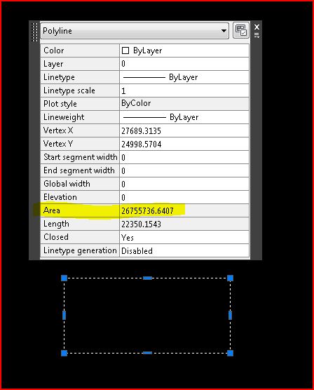

DODGE Posted April 29, 2013 Share Posted April 29, 2013 Hi Guys This is probably a dumb question, but I don't use the area calculation tool that much. I was just working out a large area for concrete. I use TOOLS - INQUIRY - AREA. Thats all fine and it gives me the area, for instance, to keep it simple 4900 x 9000 = 44.10m² AutoCad displays it as 44100000. I know it's not a major problem, but is there anyway I can get it to display as 44.10 or at least lose all the zeros. Many thanks in advance Quote Link to comment Share on other sites More sharing options...
Dadgad Posted April 29, 2013 Share Posted April 29, 2013 Are you working with polylines? You could create a field, and set the additional formatting to describe it however you want. If you use QUICK PROPERTIES, just set it up to include AREA as one of the properties you want displayed for POLYLINES. Quote Link to comment Share on other sites More sharing options...
Dadgad Posted April 29, 2013 Share Posted April 29, 2013 Better yet, as is usually the case, Lee Mac has any number of better ways to do it. http://www.lee-mac.com/areastofield.html http://www.lee-mac.com/arealabel.html There are even more on his site. Thanks Lee! Quote Link to comment Share on other sites More sharing options...

welldriller Posted May 5, 2013 Share Posted May 5, 2013 DODGE If you did not use lee-mac's program the following will work in AutocadLT 2000 choose -> FORMAT choose -> UNITS in UNITS in the PRECISION block change from 0.0000 to o.oo choose -> OK Then use the AREA command and choose all 4 corners Press -> ENTER Quote Link to comment Share on other sites More sharing options...
eldon Posted May 5, 2013 Share Posted May 5, 2013 welldriller, I think that DODGE's problem was that his drawing units were millimetres and he wanted the area in square metres. It is necessary to divide the area by 1000000. I don't think that setting the units precision would help very much in this case. Quote Link to comment Share on other sites More sharing options...
welldriller Posted May 5, 2013 Share Posted May 5, 2013 welldriller, I think that DODGE's problem was that his drawing units were millimetres and he wanted the area in square metres. It is necessary to divide the area by 1000000. I don't think that setting the units precision would help very much in this case. eldon you are 100% correct -- I used the op's dimensions and can not find a way to get it to work. Looks like he is going to have to use one of lee-mack's fine programs Quote Link to comment Share on other sites More sharing options...

Guest AARi Posted May 9, 2013 Share Posted May 9, 2013 http://www.cadtutor.net/forum/attachment.php?attachmentid=41663&stc=1&d=1367216532 make a dinamicTABLE/ use the area [polilines-boundaries] BUT using [FORMULA] as field to get your numbers correctly Quote Link to comment Share on other sites More sharing options...
