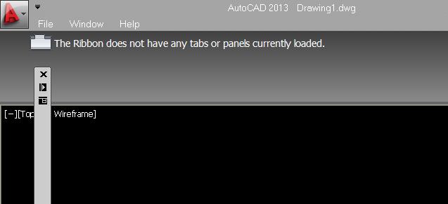

The 'Edit' pulldown menu is missing from my version AutoCAD 2013. Additionally, the commands found in that pulldown are disabled, so 'undo' 'copy' 'paste' and etc are all non functional. The 'View' 'Format' 'Insert' 'Tools' pulldowns are also missing. Everything in the ribbon, also gone.
The problem occurred when CAD froze and I had to restart the computer. CAD was really laggy beforehand. Besides that everything was normal.

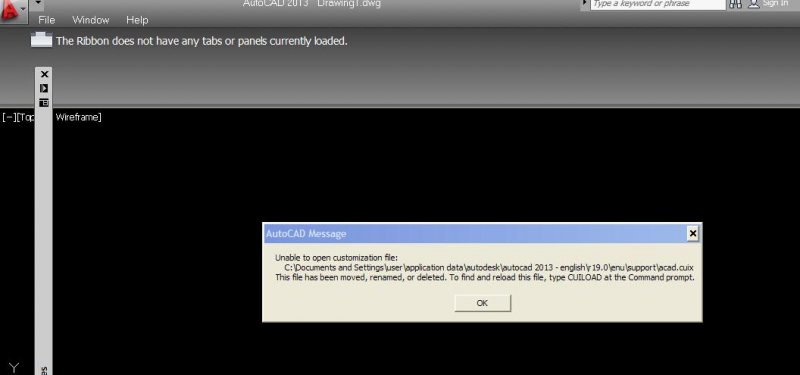

I tried repairing and reinstalling with the original disk with the same issues. Do I need to do an uninstall/reinstall? It's not the MENUBAR command, and the CUI command comes up with an error saying it cannot be located. Thoughts?
Attached are images, please help! Thanks in advance!

In all the confusion did you ever try changing or resetting Profiles?
Thankyou! I reset the profiles and the tabs returned. I lost my workspace settings but this is preferable. What mistake did I make and why didn't the edit commands work?
Thank you so much!
