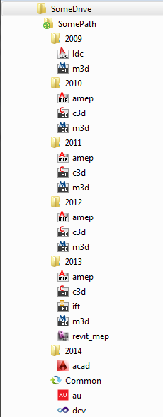

So you suggest creating 2 Acad.lsp and/or AcadDoc.lsp files in 2 seperate directories? 1 for ProSteel 3 and 1 for ProSteel 4. Then I just modify the "Support File Search Path" in each of the ProSteel 3/4 profiles to point to the appropriate Acad.lsp?
All I can do is offer what has worked well for us... If you find value in that as it might apply to your situation, that's great.
Essentially, our support structure is scaleable by design to allow for new versions being implemented. Inherently we add a 'Common' area where things that are not version-specific reside. As for our SFSP, while we obviously require some local install paths (especially using verticals), most of our SFSP is on the network, where part is read-only to most, and the remainder is personal network space where only that user has access. The former is where we keep enterprise support files, and the latter is where users keep their customizations which is also mapped into our setup for ease of use.
As a result of our support structure, it's easy to keep the Acad.lsp, and AcadDoc.lsp files organized as well, as these are considered to be version-specific resources, and located accordingly.
So as an example path for Acad.lsp, and AcadDoc.lsp in one of our Profile's SFSP:
SomeDrive:\\SomePath\\2012\\C3D\\LISP\\
... Managing the Profile via Acad.lsp is as simple as replacing \\2012\\ with \\2014\\ in various places, such as my call to vla-Put-SupportPath, etc., and everything else falls into place for the new Profile.
Replicate, and refine. Lemon squeezy.
Edited by BlackBox
I thought an image might help with the example provided; see my previous post.
