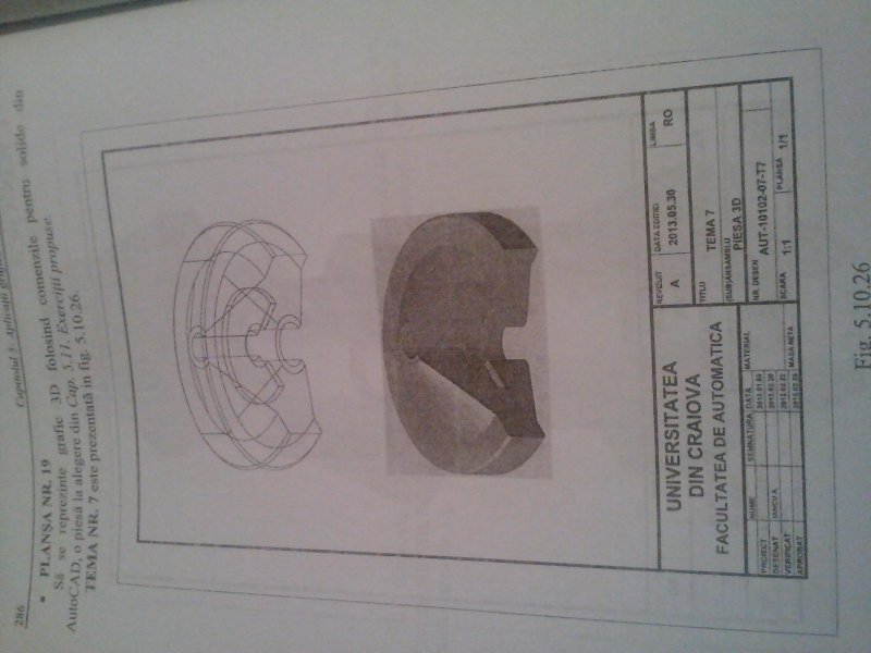

Please help me with this 3D figure, not the whole paper, just the 3d figure. I'm running out of time...
Thank you for your help!
Draw the profile of the object and revolve it.
Where are you stuck? This is a pretty simple model, just draw the profile of the part and then REVOLVE around it's center line.

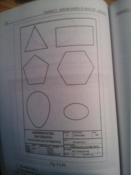

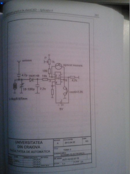

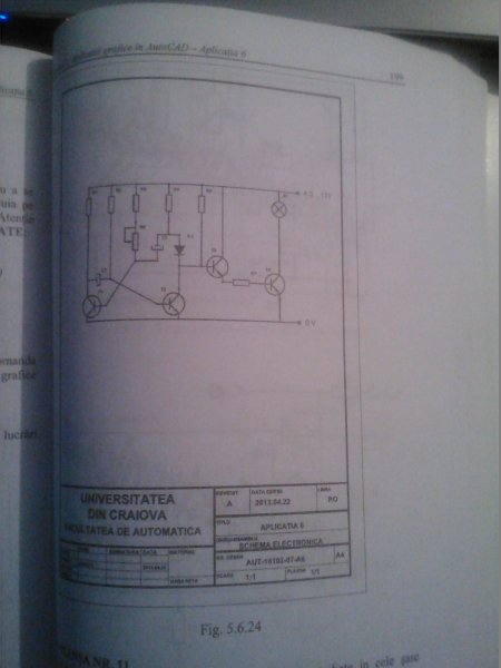

Also I attached some models I handled to make by myself:

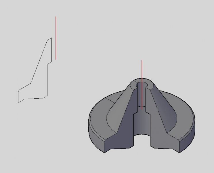

This should give you the basic idea re: REVOLVE command.
The profile is on the left. The red line is the object we revolve the profile around (270 deg). The finished 3D solid is on the right.
No, this isn't exactly like your posted image. It's up to you to provide that profile.
