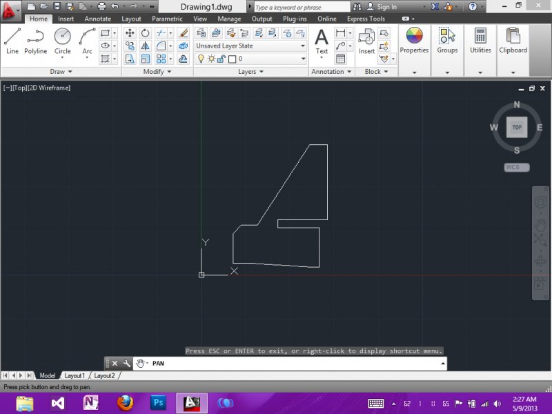

Ok, i'm there, I got the revolve funtion waiting, i managed to remove the line, but my problem is that I can't visualize the 2d... I tried something but it's not quite what I need!...

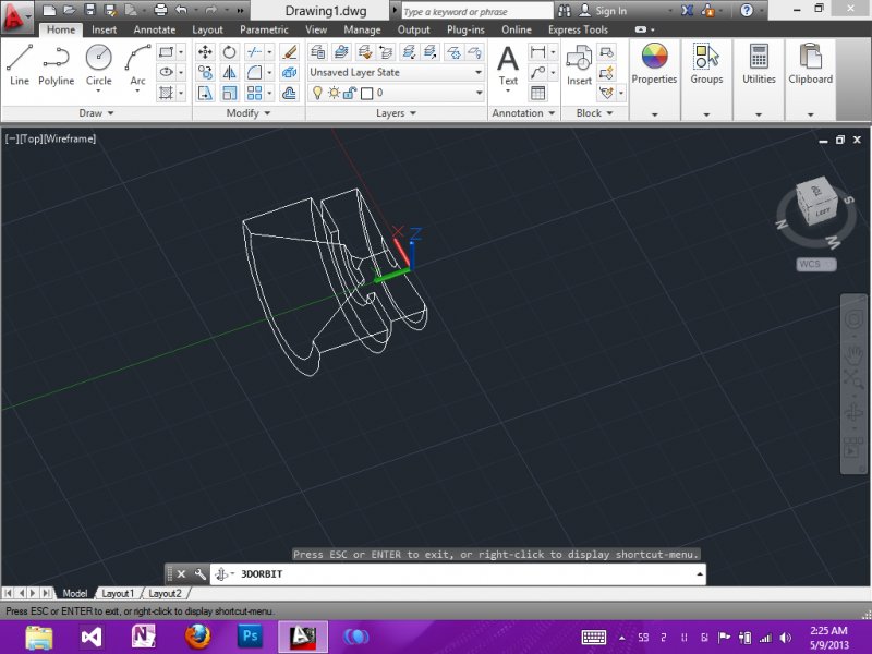

I'm goint to attach you 2 screenshots. This is considered help, so someone can help me and tell me were I'm wrong when I've done the 2D model that needs to be revolved, or if I have mistaken the points of revolving.
I chose the first time the bottom line on 0--x axis, and the second time the first line from 0--y axis.
Also I can see on the figure 3 lines internal (like the part is made out of 3 parts, 2 small and one slightly larger) is that made separately with pline, or the figure must be revolved @ 45 degrees (i think) instead of 90 (like I did in the screens attached)? Also x2, is it ok if I used the function EXPLODE to remove the extra internal lines?
See post #20 by ReMark, your profile should be similar to that, also notice the revolve axis offset to create the hole. If done properly, no need to explode.

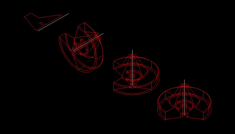

Do NOT explode anything. You're looking at a 2Dwireframe so you are going to see things you normally would not see if your visual style were conceptual or realistic.
The sequence as shown using a 2Dwireframe visual style.
The same drawing/view but this time I've used a conceptual visual style.
Create your profile.
Revolve it.
Rotate it into position.

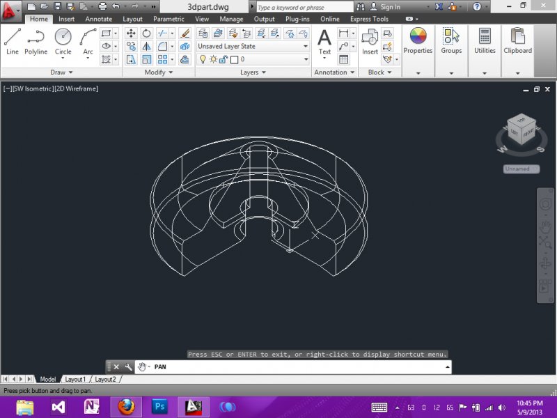

Ok, as I see in your drawing, you have a similar 2D just like I did, so that, I think I did correctly (please correct me id I'm wrong), But I didn't quite understand how you manage to revolve it like that. In the first drawing (just the one with the lines, no revolving) is it somehow bent, or is it just 2D? Can you somehow show me the process of revolving for my example, meaning how the final picture shows exactly like my homework, and not like my noob version?
Those style I understand how to use, but please be more specific (As I said, the REVOLVE command was... unexpectedly easy to use, but I don't have the time anymore, yeah, I was a little more dumb I didn't listen to you the first time, and now...
Ok, so to build my crippled part I used the following commands: ZOOM, PAN, PLINE, REVOLVE, ROTATE3D. What are the next commands to use?
You can use the 3DRotate command or the "Gizmo" as it is called to reorient your 3D model. I still use the old school method of changing the orientation on my UCS then using the normal rotate command.
You do realize I made both images while I was in an isometric view of the model don't you?

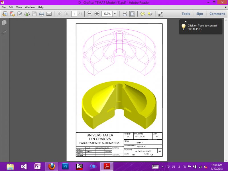

Here is my object, my final draw, is it right?
I found a solution. I render the file and add it as a PNG.
I will come back with a PDF Attachment so you can check it and give me the OK! :)

This is my final product. Did I do well?
