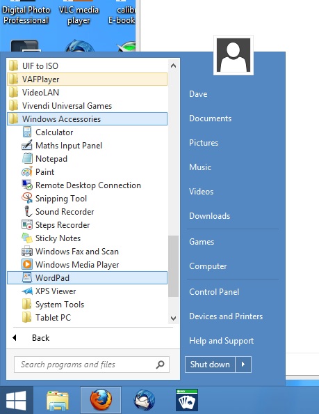

I use Start8 by stardock which gives me a desktop. That allows this....
