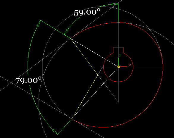

Lee Mac Posted May 16, 2013 Share Posted May 16, 2013 Constrained by the given dimensions, I don't believe all four arcs can be cotangent. After constructing the first three arcs to be cotangent and adhering to the given arc dimensions, the radii for a cotangent fourth arc (shown below in yellow) are unequal: Unless I am mistaken, for all four arcs to be cotangent, some dimensions must change. Quote Link to comment Share on other sites More sharing options...

Lee Mac Posted May 16, 2013 Share Posted May 16, 2013 There is no dimensional information provided that indicates the R45 is concentric with the hole for the shaft. Good point - this was an incorrect assumption in my construction. Quote Link to comment Share on other sites More sharing options...
Lee Mac Posted May 16, 2013 Share Posted May 16, 2013 There is no dimensional information provided that indicates the R45 is concentric with the hole for the shaft. JD, Looking back at the diagram, surely the R45 arc spanning 90 degrees implies concentricity with the shaft? Quote Link to comment Share on other sites More sharing options...
JD Mather Posted May 16, 2013 Share Posted May 16, 2013 Which makes more logical sense - all arcs tangent and endpoint coincident or R45 concentric? Have to choose one or the other (in this case). How can an assumption be made that any arcs are tangent if they are not all tangent? I thought it was interesting to discover that there is one unique solution with only the information given if all arcs are assumed to be tangent and no other assumptions. Quote Link to comment Share on other sites More sharing options...
Lee Mac Posted May 16, 2013 Share Posted May 16, 2013 Which makes more logical sense - all arcs tangent and endpoint coincident or R45 concentric? Have to choose one or the other (in this case). If R45 is not concentric, the angular measurements are surely meaningless since they do not pass through the arc endpoints - what exactly are they dimensioning? If the angular dimensions need not pass through the arc end points, the shaft could be placed anywhere within the cam. Quote Link to comment Share on other sites More sharing options...

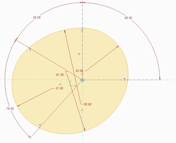

JD Mather Posted May 16, 2013 Share Posted May 16, 2013 If R45 is not concentric, the angular measurements are surely meaningless since they do not pass through the arc endpoints - .... But they do pass through the arc endpoints. Here is Creo (Pro/E) solution (of course, same as the other solutions I've posted). You can see the blue dots indicating the arc endpoints of the arcs on the lines. Notice also the T for tangents between arcs. Post #32 shows AutoCAD solution with Coincident endpoints and Tangent curves. Post # 47 shows the same for SolidWorks. Quote Link to comment Share on other sites More sharing options...
Lee Mac Posted May 16, 2013 Share Posted May 16, 2013 But they do pass through the arc endpoints. My apologies JD, I was hung up on the R45 arc spanning 90 degrees - a false assumption. Thank you for your correction! Quote Link to comment Share on other sites More sharing options...

JD Mather Posted May 16, 2013 Share Posted May 16, 2013 I strongly suspect that the 45R is essentially concentric with the shaft in that drawing. .... You are right. I remember this problem from back when I used to teach on the drawing board. The R45 is concentric and the rest was all a fudge. A good example of why we moved to CAD. I used to assign this when we moved to CAD, but stopped using it because it didn't come out right (as some have found) with the R45 concentric. A better example of why to use Parametric CAD. This is the first time I tried it with parametric geometry constraints not making any assumptions that I wasn't sure of (I think it is very safe to assume the assumption that the arcs should be tangent and coicident at the endpoints). I was surprised when the problem solved without needing another dimension or a constraint of the R45 to the origin. I am going to use this one for classes again - with the warning to not make any assumptions other than those which can be defended as logical. Quote Link to comment Share on other sites More sharing options...
