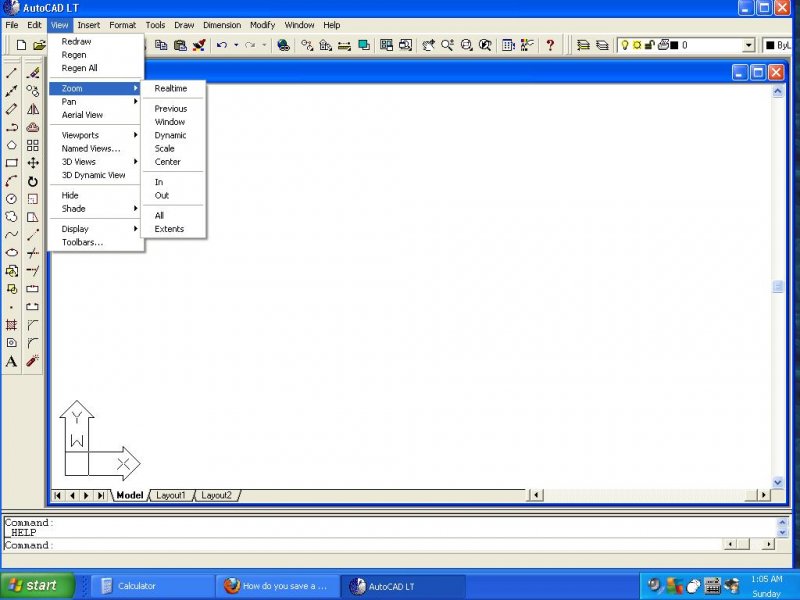

Ok lack of knowledge on my part i have never used the zoom extents function for what i do (is for myself and family) i have always just used model space and layers ashamed to admit it but i have never used layouts. i need to start working on that.
You should try it; it's very easy (ZOOM Extents) and quickly zooms you out to see everything.

Zoom extents merely zooms you out to where you can see everything in the workspace image, whether it is in model or on a paperspace layout. It is a button on my zoom toolbar. I dunno if 2000 even has toolbars, much less buttons,:unsure:

yes i do ooops it put the screen shot above and not below where i wanted it. oh well this tells the tail
