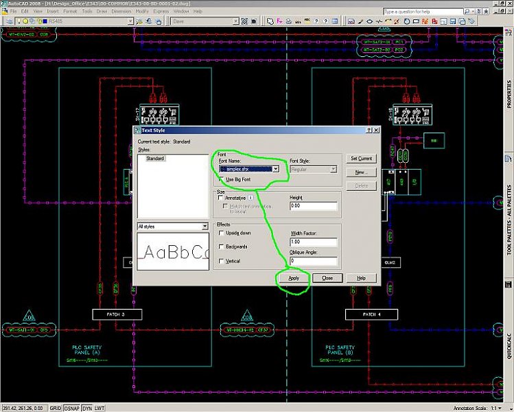

Tankman Posted December 6, 2008 Posted December 6, 2008 You need to change the font for the Apply to highlight. Once done just exit or exit and REGEN. Highlighted the entire drawing, "STYLE" on the command line. Picked a font, "APPLY." Changed all fonts, including the dimensions and title block. Worked fine. Quote

gsksun4 Posted December 8, 2008 Author Posted December 8, 2008 Highlighted the entire drawing, "STYLE" on the command line.Picked a font, "APPLY." Changed all fonts, including the dimensions and title block. Worked fine. I tried this and it did not work. It still lists out as the old STYLE NAME. The font is fine, it seems to be the STYLE NAME that will not change. Quote
dbroada Posted December 8, 2008 Posted December 8, 2008 the style name cannot be changed globally. The style is applied to each text object as you create it or later if you desire. All you can do is change the font associated with that style - which is what you asked and have had replies to. If you want to change a text object's style you should use qselect & the properties palette. Quote
