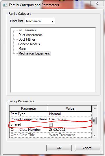

How do I ensure the sub-family is shared? - can you post a screen shot of the command?
Share this post
Link to post
Lee Roy
Within the family that is to be shared (ie- the sub-family or nested family), make sure this checkbox is checked.
