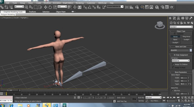

AlienBZ Posted May 13, 2013 Posted May 13, 2013 I'm trying to rig this boy model which I d/l from one of the free model sites linked to from this site, I had a thread going over at the Area, but it looks like the people over there don't seem to be helping me, so I'm asking over here where I usually hang out. I have a book that I was using several months ago, doing a tut from this book "3DS max 6 animation and visual effects techniques" by Sanford Kennedy, starting with the tut on page 209 (tut 7.1 Build the basic skeleton). I was following this tut faithfully but for some reason or another, each time I used the tut 7.1 instruction files from the book's CD to create this skeleton, using the animation > bone tool, my bone chain always, without exception, lays flat at a 90 degree angle to the model's body, as you can see in this screen capture: and I cannot understand why my chain of bones (leg/thigh,etc) bones are at a 90 degree angle to the model's body. Here is my thread from the rigging section over at Area: http://area.autodesk.com/forum/autodesk-3ds-max/rigging/how-do-i-rig-this-model-a-childyoung-boy-model/ I also have this biped animation book I bought, the title is: 3DS max animation with biped by Michele Bousquet and Michael McCarthy. both of these books include a CD. Could you guys please tell me how to make the bone tool in my 3DS max (v2011) behave the way it is supposed to when I create the bone chains (up/down direction for thigh/lower leg/ball of foot/toes) and (left/right for upper arm/lower arm/wrist/hand/finger/thumb bones)? Thanks in advance. Quote
Cad64 Posted May 14, 2013 Posted May 14, 2013 Are you trying to create bones in the Perspective viewport? You need to be viewing your character in an orthographic viewport when creating bones, (Front, Left, Top, etc.). Your books should have mentioned that. Take a look at this video tutorial: http://www.youtube.com/watch?v=PlCMkYzkfrk Quote
AlienBZ Posted May 14, 2013 Author Posted May 14, 2013 Are you trying to create bones in the Perspective viewport? Yes, I guess I am. But what difference does it make (just wondering)? Quote
Cad64 Posted May 14, 2013 Posted May 14, 2013 Bones will always be created on the active grid, and in the perspective viewport, that is the XY plane. So create your bones in an orthographic front or side viewport. Why don't you just use one of the preset CAT rigs, or build a CAT rig from scratch? http://docs.autodesk.com/3DSMAX/16/ENU/3ds-Max-Help/index.html?url=files/GUID-B28DB94E-2DD7-442A-96C1-53CE40998393.htm,topicNumber=d30e329647 Quote

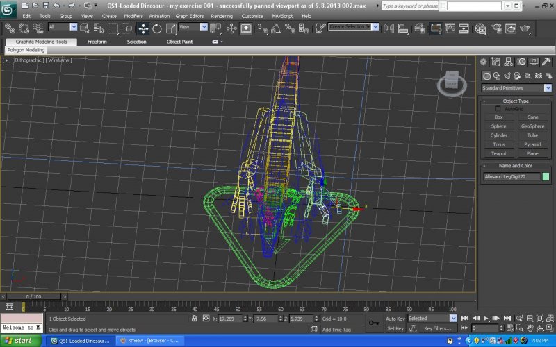

AlienBZ Posted September 9, 2013 Author Posted September 9, 2013 ok, I've finally figured out how to add the skeletons (CAT objects > parent) for whichever model I'm trying to animate (Quick start in 3DS Max 2011 Bible, having finally located the DVD) I'm on pg 10, step 4 in the tut of rigging up the walking dinosaur, but for the life of me I cannot figure out why, when I'm selecting/moving the appropriate bones into the skin mesh from the edit menu, the individual joints (toes/digits) turn out crooked, like as if the dinosaur was born with cerebral palsy, etc? to date I've got both R & L back leg bones positioned (thighs/shins) within the skin mesh, but for some strange reason the foot/palm bones of the back feet will not move in such a way so as to be within the feet meshes (which stands up nearly as straight up/down like a steeple) but the palm bones remain fixed at a 45 degree angle from the shin bones of the legs down to the ground/floor of the model's outdoorsy scenery - how do I get the palm bones to position squarely within the confines of the feet meshes? see images QS5-Aligned CAT rig.max Quote
AlienBZ Posted September 17, 2013 Author Posted September 17, 2013 I do not want to create a "disabled" dinosaur (that is, a dinosaur with cerebral palsey) I am very sorry I mentioned this. All I wanted to do is fix the crooked bones in this rig so it would look right. Isn't anyone going to help me fix these bones in this rig? Quote
Cad64 Posted September 17, 2013 Posted September 17, 2013 Isn't anyone going to help me fix these bones in this rig? I don't think anyone here does animation like this. Haven't you been able to find help with this sort of thing on the other forums I pointed you to previously? Quote
