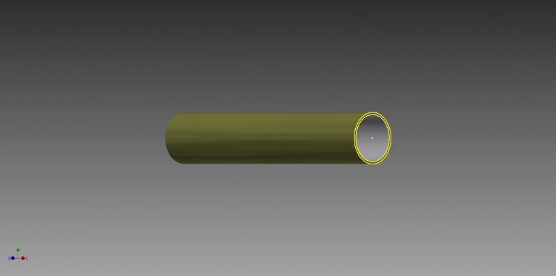

I am working on a Design I need to create Female thread inside a Ti. Tube. I can make external threads but if I select the inside "wall" all of the thread options are greyed out. I did a forum and google search and nothing really covered what I need.

Her is a Jpeg and IPT of what I have so far.
Supressor Body.ipt

What size of thread are you trying to place?

The inside Diamater of the part is 1.600 so 1.600 X 24 TPI Female Thread Extending from the End of the Workpiece .75 In on one side and .5 on the other. In other Words I will have end caps that thread into that tube on both ends.

....The inside Diamater of the part is 1.600 so 1.600 X 24 TPI Female Thread...
Hole size must be smaller than thread size - or there will be no material in which to cut the threads.
The Hole Feature command will put the correct tap drill size and the thread (cosmetic) for you.
Ok Think I got it. Still not sure on the thread I should go with for an ID of 1.650 So I think I will need to create a custom thread or increase my wall thickness to reduce the ID but I really don't want the added weight.
