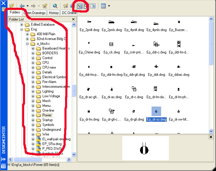

With regards to using Design Center, it would appear this gives you a nice tidy access to numerous blocks of different disciplines, which are merely "libraried" within normal "*.dwg" files found in the (*\Program Files\AutoCAD 2005\Sample\DesignCenter) folder.
Two questions: (If i may)
1) Can I edit these *.dwg's to "add" more blocks to these drawings without causing harm to the program?
2) Can I customize the location of the "Design Center" folder? Lets face it, that folder's buried pretty deep, not to mention, If I can "customize/add to" those dwg's, would be nice to have the folder located on a drive which is in my normal data backup routine.
I looked under "Tools/Options" "Files" tab, thinking that would be the logical place to change the path to that folder, but don't see it already in there. Is this doable?

David,
Did you get an answer to your questions? If not...
(Q2) If '05 is the same as '06-'09 has been, you should be able to pick the folder tab within design center and then browse to a new drive and subfolder where you have created a "custom library" so to speak.
This is what we have done, created our own library structure on a networked location and reference it through "Folders" in Design Center.
For some of our more frequently used blocks, we have made tool pallets out of. You can do this by dragging a folder from your design center view to your tool palette. Once you have done this, you can set the insertion properties for each item on the palette (i.e. scale, rotation, layer & color). If you do this then you can pick it from the Palette list and drop it in the drawing as you typically want it.
(Q1) I would then make a copy of the blocks you think you will want out of the AutoCAD supplied folders and put them in your custom library location and make your modifications in that new location.
Make sense?

You should be able to browse a folder tree on the left side of the Design center dialog box (if you have the folders tab highlighted). If you don't have this tree showing click on the "Tree View Toggle" icon on the top.
Attached is a jpg image with red markup to show the areas I'm talking about.
Yes, I have the tree view in DC. Whenever I opened DC it always opened in the default location (buried deep) in the Programs Files folder.
But just now, I opened AC, opened DC, navigated up to the C drive, closed AC and when I reopen Autocad and DC I see that it now opens in C, not drilled down into the program files folder.
This may be a viable alternative.
Thanks.
Addendum:
Indeed, I tried several different situations, of closing Design Center, then Autocad (after selecting a new folder in Design Center) and whenever I open Autocad back up, regardless if DC is already open or not, it opens in the last folder I was in.
Very convienient, thanks yrnomad!
