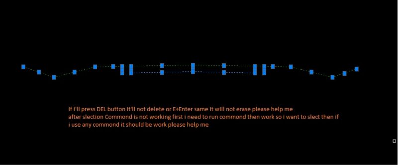

afrazawan Posted May 23, 2013 Share Posted May 23, 2013 if i'll press DEL button it'll not delete or E+Enter same it will not erase please help me after slection Commond is not working first i need to run commond then work so i want to slect then if i use any commond it should be work please help me Quote Link to comment Share on other sites More sharing options...
MSasu Posted May 23, 2013 Share Posted May 23, 2013 (edited) Please ensure that PICKFIRST system variable is set to 1. Edited May 23, 2013 by MSasu Fixed name of variable Quote Link to comment Share on other sites More sharing options...
SAFeSTeR Posted May 23, 2013 Share Posted May 23, 2013 I think MSasu means PICKFIRST Quote Link to comment Share on other sites More sharing options...
MSasu Posted May 23, 2013 Share Posted May 23, 2013 Ooops... Entirely true! Thank you for correction SAFeSTeR! Quote Link to comment Share on other sites More sharing options...
afrazawan Posted May 25, 2013 Author Share Posted May 25, 2013 thank yo so much my all friends problem solve Quote Link to comment Share on other sites More sharing options...
