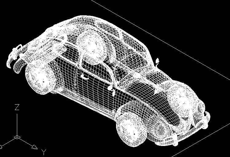

as pocket has mentioned a lot of patience, but it will also involve a lot of skill. i have this model of a classic beetle, i only ended up modelling the wheels and some body surfaces,, lolz. I had no precise data on the measurements to draw out the body surfaces precisely so i abondoned it :D
here's the model i was basing it on w/c was made in 3d viz, and as you notice,,, its not easy
the bonnet on that looks too long
I was debating whether it was something more PT Cruiser until I spotted the classic shape of the bonnet
its the 1950 model, its hood is a little longer than the later models like the super beetle.
