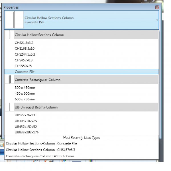

PotGuy Posted July 4, 2013 Author Share Posted July 4, 2013 Got a PS. Revit Structure 2012. You can see my 'custom' Concrete Pile Quote Link to comment Share on other sites More sharing options...
tzframpton Posted July 4, 2013 Share Posted July 4, 2013 Ah.... sorry for the confusion. I was referring to a Family Category not a Loadable Family like you were stating. My apologies on that one. How is it working out for you? FWIW, you'll have to load the same Loadable Family for Column, Beam, Brace Families, etc to make your life easier. All the different types of structural members act differently. Quote Link to comment Share on other sites More sharing options...
