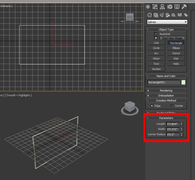

Cad64 Posted June 8, 2013 Share Posted June 8, 2013 Using your example of the rectangle, you can set the exact size by adjusting the spinners under the "Parameters" rollout as shown in the screenshot below. You can also apply a corner radius there as well which would mean you don't need the Fillet/Chamfer modifier, unless you are creating a chamfer, then you will still need the modifier. If you do use the modifier, and you want to finalize the action, just right click on the "Fillet/Chamfer" modifier and choose "Collapse To" from the pop up menu. That will apply the modifier to the rectangle and remove it from the stack. That pop up warning message is just to remind you that there is a modifier on your object, so if you change anything about your object, it may effect the way the modifier works. Quote Link to comment Share on other sites More sharing options...

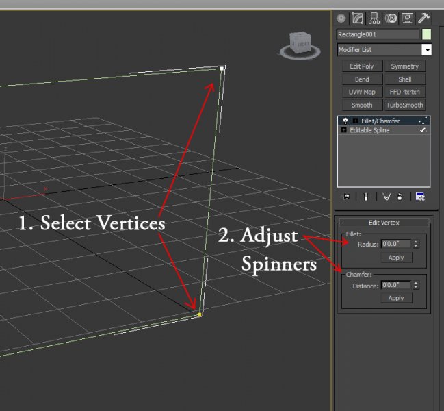

Cad64 Posted June 8, 2013 Share Posted June 8, 2013 Also, in case you didn't know, the Fillet/Chamfer modifier works on selected vertices. So if you wanted to chamfer all 4 corners you will need to window select the 4 vertices of the rectangle and then adjust the chamfer distance spinner for the amount of chamfer that you want. Or you can pick individual vertices and chamfer each one a different amount. Or you could chamfer the 2 bottom corners and fillet the 2 top corners or whatever you want. You just have to select the vertices you want to effect and then adjust the spinner. Quote Link to comment Share on other sites More sharing options...
