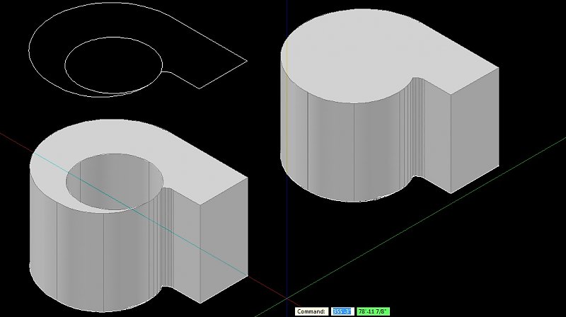

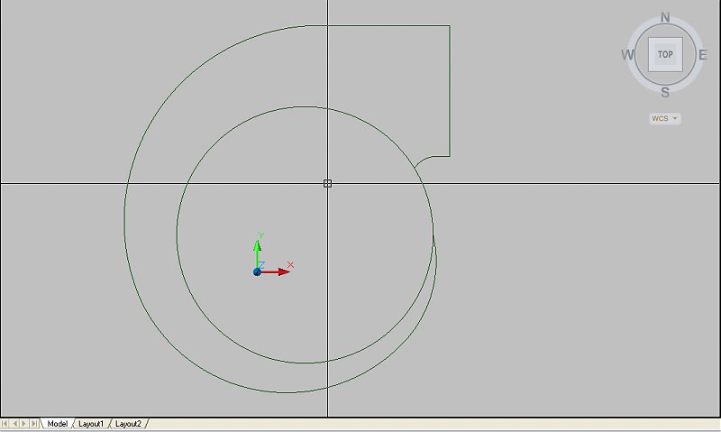

Walks Posted November 19, 2008 Share Posted November 19, 2008 What's up everyone .... I've been using AutoCAD in a 2D world for quite some time but have only just recently dived into 3D. I've done a ton of modelling tutorials, etc. but am having a hard time with this particular problem. I'm modelling a fan (I work at an HVAC engineering company) and for the life of me, cannot figure out how to create a face that involves multiple lines, arcs & circles of the object attached. The circle in the 'middle' is fine as is but I want to create a face or a solid of the object outside the circle. I've tried a ton of different things but can't seem to get the result that I'm looking for. Any thoughts ??!! Help !! Quote Link to comment Share on other sites More sharing options...
GhostRider Posted November 19, 2008 Share Posted November 19, 2008 I think a solid in that shape could be modeled by extruding a polyline of the outline, then you could copy a face ..... I'll try it and post an image to see if that is what your after Quote Link to comment Share on other sites More sharing options...
Walks Posted November 19, 2008 Author Share Posted November 19, 2008 Outstanding !!! That's exactly what I'm looking for (bottom left). So, what process do I have to go through to achieve this ?? Thanks a ton !! Quote Link to comment Share on other sites More sharing options...
GhostRider Posted November 19, 2008 Share Posted November 19, 2008 you have the drawing shown in your first post, just create a closed polyline of the outline, using pedit join option and extrude it. extrude the circle in the center longer than your outer part and use subtract to create the hole... I cheat creating the close polyline using a lisp called peditjoin.lsp it just makes it a bit easier, I think I got it here on this forum, from lpseifert or one of the lisp experts here.. (defun c:pj () (setq pa (getvar "peditaccept")) (setvar "peditaccept" 1) (setq ssj (ssget )) (command "pedit" "m" ssj "" "j" "0.01" "") (setvar "peditaccept" pa) (princ) ) Quote Link to comment Share on other sites More sharing options...
