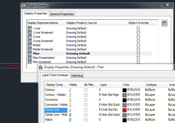

I'm drawing 3d conduit and in plan view the conduit appears with 3 lines. The 2 outside lines and the one in the middle...I'm trying to eliminate the line in the middle...I played around in my display manager a bit but I cant seem to find it there. Am I not seeing something? Or do I have to shut it off somewhere else?

Brand new to MEP myself, but try switching to a different Display configuration on the status bar. Medium Detail and Standard will show the 3rd line in top/plan but most of the others don't
Quickest way is to do the following:
Select the conduit, right-click > Edit Object Display which will bring up a dialog box. Under the Display Properties tab, highlight the Bolded Display Representation and click the button on the top right of the dialog. This gives you all the object's possible visual controls. Turn on/off Centerlines from here. Also you can control other things as well - start getting familiar with this and notice what controls what.
This will change the conduit globally. If you wanted only the object to not show the Centerline then click the "Object Override" checkbox on the Bolded Display Representation.
Hope this helps.

If you want to change the standard and medium detail display configurations, go to the display manager. Go to configurations
For whatever reason when I tried to edit the objects display there are two display representations listed in bold, plan and 1-line. Both have their center lines turned off already. This is only when I am in standard and medium detail. so those two display configurations (standard andmedium detail) are using the single line display representations to get the extra center line displayed.

Display Manager is most certainly a beast. From Autodesk's lips - they say to not attempt to build the Display Representation from scratch; use what's there and edit as needed.
One thing that really helped me better understand the Display Manager is the differences in user-defined Display Representations versus pre-defined. Reference my screenshot above. On the Object Display dialog, refer to each list of Display Representations. The icons to the left are almost identical, but you'll notice a silhouette of a person in some of them. These are user-defined, or "custom" and can be completely removed. So, in saying this, there are four basic Display Representations that you must stick with and use: 1-line, 2-line, Model and Plan. Once this basic idea is grasped, the Display Manager becomes much more logical. Refer to this link for more descriptions on the differences:
