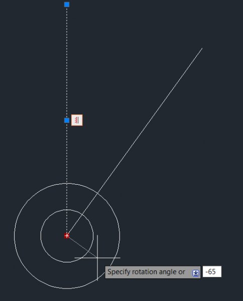

JD Mather Posted June 16, 2013 Posted June 16, 2013 Then draw a line from the centers of the circles vertically. type L and hit Enter click one of the circles (AutoCAD should find the center, if not post back and we'll fix that) move your cursor vertically and click for a length on the line about like this image. (don't worry about the angled line yet) Quote
JD Mather Posted June 16, 2013 Posted June 16, 2013 Now - click on the vertical line and then click on the grip at the center of the circle. Click Right Mouse Button and select Copy. Click Right Mouse Button again and select Rotate. Type -65 and hit Enter. Save and attach the file here. Quote

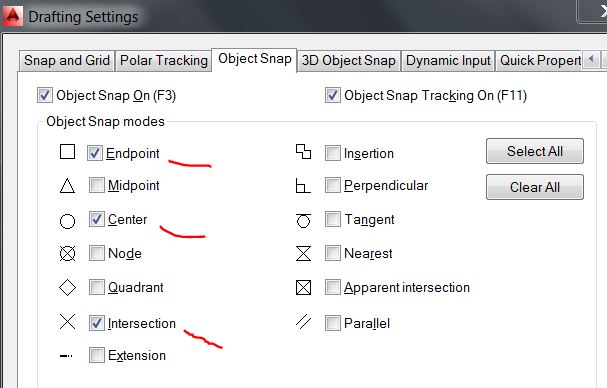

JD Mather Posted June 16, 2013 Posted June 16, 2013 Oops, we need to back up, the circles are not concentric (sharing same center point) and the line is not even close to vertical. Delete the second circle and delete the line. Quote
JD Mather Posted June 16, 2013 Posted June 16, 2013 Type the command osnaps on the keyboard and hit Enter. Set exactly as shown in image (Endpoint, Center, Intersection). Quote
