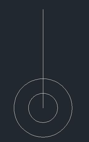

kushab Posted June 16, 2013 Author Posted June 16, 2013 the circles are not concentric and the line is vertical. Drawing5.dwg Quote
JD Mather Posted June 16, 2013 Posted June 16, 2013 Then draw the second circle again. (you did erase it and the line like I instructed - correct?) When drawing the second circle type C and hit Enter Click ON the first circle (AutoCAD will find the center point for you) type D and Enter type 3.5 and hit Enter (Edit: I see you now have this correct in Drawing5) type L and hit Enter click on the circle (AutoCAD will automatically find the center of the circle) click above the circle (in Drawing5 you attached the line is not vertical and is not a simple Line) It should look like this Quote

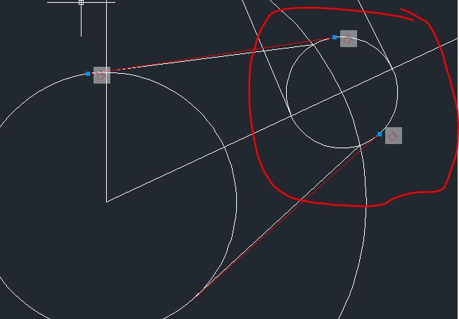

JD Mather Posted June 16, 2013 Posted June 16, 2013 You are missing a step. You MUST Shift Right Mouse Button select Tangent for placing BOTH ends of the lines (there is an automatic way, but I want you to master this way first.) Your lines are not tangent at both ends. Quote

kushab Posted June 16, 2013 Author Posted June 16, 2013 THe course is free and the teacher isn't good enough. I arrived until here it has a mistake between the 0.75 and .50 circles i do not now how Drawing10.dwg Quote
JD Mather Posted June 16, 2013 Posted June 16, 2013 There are mistakes with most everything you have done except for the bottom and sides of the piston. First all of the tangent lines between the 1.75 and .75 and between the .75 and the .5 circles are incorrect. You must follow this procedure precisely (this is the third time now I've explained. Delete your four tangent lines. 1. type L and hit Enter 2. hold Shift key and Right Mouse Button then select Tangent 3. click on the bottom of the 1.75 circle 4. hold the Shift key and Right Mouse Button then select Tangent 5. click on the bottom of the .75 circle 6. Hit Escape 7. type L and hit Enter 8. hold Shift key and Right Mouse Button then select Tangent 9. click on the top of the 1.75 circle 10. hold the Shift key and Right Mouse Button then select Tangent 11. click on the top of the .75 circle Now repeat steps 1-11 on the SIDES of the .75 and the .5 circles. Attach the file here. Quote
