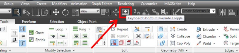

Ok, it took me a while to figure it out, but here's your answer. Turn off the "Keyboard Shortcut Override Toggle" by clicking the button on your toolbar that looks like an up arrow.
Looks like I learned something new today. :)
Cad, You're a real life saver!!! Cant thank you enough. you dont know how many sites i've went to with so many combinations of search words at google and come up with nothing haha!
