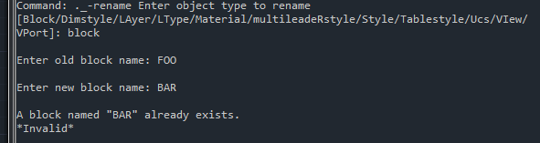

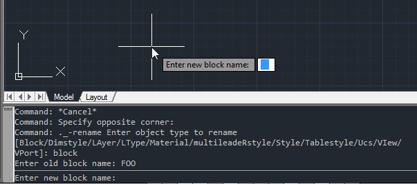

I'm interested, but can you show an example of what the interface looks like after selecting Rename > Block from the right click menu. Also, what's the prompt if the new name already exists?

The real value of this plug-in is the ability to graphically select a single entity, and have contextual access to rename entity-specific Properties (that can be renamed, otherwise disabled), without the need to manually invoke a Command, or scroll through the RENAME dialog itself to hunt for which item you want to modify, etc..
This plug-in uses the built-in -RENAME Command, where the 'old name' is supplied for the user programmatically, and the user need only enter the 'new name':
... Thus, in the case of entering a Block name that already exists, the native behavior will result:

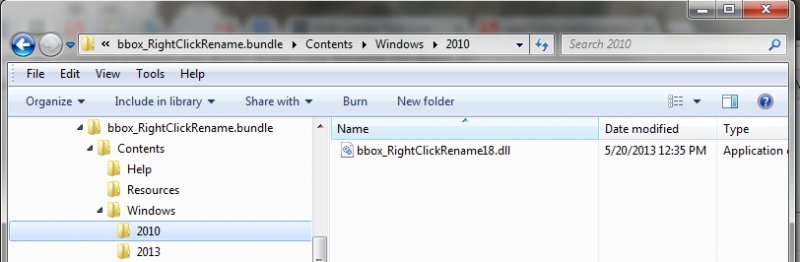

You'll have to walk me through it... NetLOAD is asking for a dll, how do I locate that?
*edit* Alright, I pulled my head out of the sand and located/loaded the dll. Now I have to figure out how to automatically load it for each session.
The installer placed this plug-in .bundle here:
%AppData%\Autodesk\ApplicationPlugins\bbox_RightClickRename.bundle\
... And if you drill down to Contents, Windows, 2010 you'll find the assembly which is compatible for all 2010 Database format versions (i.e., 2010-2012):
