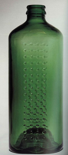

efilana Posted July 6, 2013 Share Posted July 6, 2013 Hello guys! I wanted to ask you to help me modeling WOBO bottle. I am a beginner. I found great tut on yuotube which explained how to model with loft, which I did. But, I have couple questions, if I may. 1. The resulting model has only one surface, meaning there is no thickness to the glass. How do I offset my model? 2. How do I make these little bumps? Thank you! Efilana Quote Link to comment Share on other sites More sharing options...
ReMark Posted July 6, 2013 Share Posted July 6, 2013 You can try the THICKEN command. You could create a bump by slicing a sphere then creating an array. That would be one option. Quote Link to comment Share on other sites More sharing options...
Cad64 Posted July 6, 2013 Share Posted July 6, 2013 Is this an Autocad question or a 3D Studio Max question? You posted in the 3ds max section. Quote Link to comment Share on other sites More sharing options...
efilana Posted July 7, 2013 Author Share Posted July 7, 2013 CAD, this is about 3ds Max. Thanks, ReMark, half-sphere is brilliant simple way. Quote Link to comment Share on other sites More sharing options...
efilana Posted July 7, 2013 Author Share Posted July 7, 2013 I have one more question at the moment: when leave loft command , there is no coming back, is that correct? Quote Link to comment Share on other sites More sharing options...
Cad64 Posted July 7, 2013 Share Posted July 7, 2013 You can use a Shell modifier to add thickness to the glass. I would probably create a displacement map to add the bumps. Sticking spheres on the outside is not going to look natural. It's just going to look like spheres stuck to the glass. I'm not at my home computer currently, but as I remember, when you create an object using the Loft command, it remains a Loft object until you convert it to an editable poly. Once you convert the object to an editable poly, there is no going back. But until you convert it, the object still retains all of it's Loft parameters. Quote Link to comment Share on other sites More sharing options...
spittle Posted July 7, 2013 Share Posted July 7, 2013 How did you model the neck? You could use bevel in face sub-object mode which will be tidier than having the triangulated mesh. And then use shell. I'd also probably model this low poly, with support edges and apply a turbosmooth modifier to it to get the nice rounded edges. And then use a bump or displacement map for the details. Quote Link to comment Share on other sites More sharing options...
efilana Posted July 10, 2013 Author Share Posted July 10, 2013 CAD, I used shell modifier and it worked. so that was easy. Thank you. Spittle, I used loft commend to model the neck. I measured diameters and distances between them in autoCAD and lofted them in Max. I would imagine I could use bevel as well. I need to test it. Thank you! Quote Link to comment Share on other sites More sharing options...
