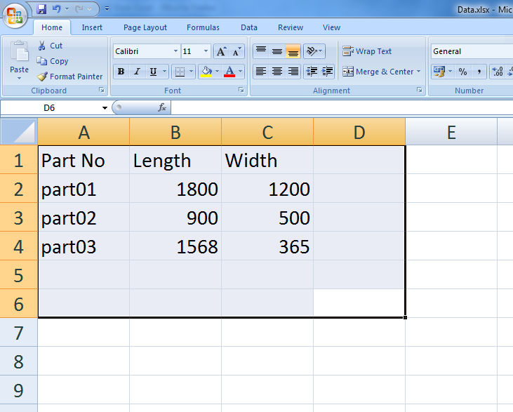

snglvl Posted July 21, 2013 Author Share Posted July 21, 2013 This is the screen shot of the file. Please, attach a screenshot of Excel file for test,it's not clearly enough how is your data filled in there Say if your coordinates in 8 columns per even row, try this example Option Explicit '---------------------------------------------------------------' ' Notes: ' 1. requires settings: Tools -> Options -> General tab -> Error trapping field -> check "Break on Unhandled errors" ' 2. requires reference to Microsoft Excel XX.0 Object Library '---------------------------------------------------------------' ' written by Sccadmember ' Date: Aug/04/06 ' [url]http://discussion.autodesk.com/thread.jspa?threadID=489202[/url] ' Just thought I would post this because I have been looking for a working VBA file open dialog box ' solution for awhile. 'I'm an old autolisped making the jump to VBA and I have seen and read ' various solutons for the equivalent getfiled 'autolisp function but I never had much luck with them. ' This one worked for me it uses the Win API to do the job. '---------------------------------------------------------------' Private Declare Function GetOpenFileName Lib "comdlg32.dll" Alias _ "GetOpenFileNameA" (pOpenfilename As OPENFILENAME) As Long Private Type OPENFILENAME lStructSize As Long hwndOwner As Long hInstance As Long lpstrFilter As String lpstrCustomFilter As String nMaxCustFilter As Long nFilterIndex As Long lpstrFile As String nMaxFile As Long lpstrFileTitle As String nMaxFileTitle As Long lpstrInitialDir As String lpstrTitle As String flags As Long nFileOffset As Integer nFileExtension As Integer lpstrDefExt As String lCustData As Long lpfnHook As Long lpTemplateName As String End Type '---------------------------------------------------------------' Public Function ShowOpen(Filter As String, _ InitialDir As String, _ DialogTitle As String) As String Dim OFName As OPENFILENAME 'Set the structure size OFName.lStructSize = Len(OFName) 'Set the owner window OFName.hwndOwner = 0 'Set the filter OFName.lpstrFilter = Filter 'Set the maximum number of chars OFName.nMaxFile = 255 'Create a buffer OFName.lpstrFile = Space(254) 'Create a buffer OFName.lpstrFileTitle = Space$(254) 'Set the maximum number of chars OFName.nMaxFileTitle = 255 'Set the initial directory OFName.lpstrInitialDir = InitialDir 'Set the dialog title OFName.lpstrTitle = DialogTitle 'no extra flags OFName.flags = 0 'Show the 'Open File' dialog If GetOpenFileName(OFName) Then ShowOpen = Trim(OFName.lpstrFile) Else ShowOpen = "" End If End Function '---------------------------------------------------------------' Function IsExcelRunning() As Boolean Dim xlApp As Excel.Application On Error Resume Next Set xlApp = GetObject(, "Excel.Application") IsExcelRunning = (Err.Number = 0) Set xlApp = Nothing Err.Clear End Function Sub CreateDxfDocuments() ' To read data from specific Excel range Dim xlApp As Excel.Application Dim blnIsOK As Boolean Dim xlBook As Excel.Workbook Dim xlSheet As Excel.Worksheet blnIsOK = IsExcelRunning() If blnIsOK Then Set xlApp = GetObject(, "Excel.Application") Else Set xlApp = CreateObject("Excel.Application") xlApp.Visible = True xlApp.UserControl = True End If Dim xlFileName As String Dim Filter As String Dim InitialDir As String Dim DialogTitle As String Filter = "Excel Files (*.xlsx)" + Chr$(0) + "*.xlsx" + Chr$(0) + _ "All Files (*.*)" + Chr$(0) + "*.*" + Chr$(0) InitialDir = ThisDrawing.GetVariable("dwgprefix") DialogTitle = "Open an Excel file" xlFileName = ShowOpen(Filter, InitialDir, DialogTitle) ' to avoid using code above try hard coded file path, ' set full path of your Excel file here: ' xlFileName = "C:\Users\User\myxlFile.xlsx" xlApp.Application.ScreenUpdating = False ' open file for read Set xlBook = xlApp.Workbooks.Open(xlFileName) Set xlSheet = xlBook.Worksheets("Sheet1") ' desired sheet name , same if use xlBook.Worksheets(1) xlSheet.Activate Dim xlrange As Excel.Range Set xlrange = xlSheet.Range("A1:H4") ' range address we interested in xlrange.Select Dim cols As Long Dim rows As Long cols = xlrange.Columns.Count rows = xlrange.rows.Count Dim rangeValue As Variant rangeValue = xlrange.Value2 ' clean up memory xlBook.Close False Set xlBook = Nothing xlApp.Quit Set xlApp = Nothing 'DoEvents ' end of work with Excel, ' go to Autocad then MsgBox "Back to AutoCAD" ''-------------------------------------------------------- Dim dxfname As String dxfname = "-Sample.dxf" Dim ptCoordinates As New Collection Dim i, j For i = LBound(rangeValue, 1) To UBound(rangeValue, 1) ReDim ptarray(LBound(rangeValue, 2) To UBound(rangeValue, 2)) As Double For j = LBound(rangeValue, 2) To UBound(rangeValue, 2) ptarray(j) = rangeValue(i, j) Next j ptCoordinates.Add ptarray, CStr(i) & dxfname Next i Dim docMgr As AcadDocuments Set docMgr = Application.Documents Dim item As Variant Dim num As Integer num = 1 For Each item In ptCoordinates Dim acDoc As AcadDocument ReDim dblPoints(LBound(item) To UBound(item)) As Double For i = LBound(item) To UBound(item) dblPoints(i) = CDbl(item(i)) Next i Set acDoc = docMgr.Add() Dim lwPoly As AcadLWPolyline Set lwPoly = acDoc.ModelSpace.AddLightWeightPolyline(dblPoints) lwPoly.Closed = True acDoc.Application.ZoomExtents acDoc.SaveAs ThisDrawing.GetVariable("dwgprefix") & CStr(num) & dxfname, ac2007_dxf acDoc.Close num = num + 1 Next item MsgBox "Done" End Sub '---------------------------------------------------------------' Quote Link to comment Share on other sites More sharing options...
snglvl Posted July 21, 2013 Author Share Posted July 21, 2013 (edited) Marvel! You are great! Thanks for the reply. It solved the problem. giving the co-ordinates in 8 successive columns, it worked flawless Two things i want to add, 1) How to select the final Directory where the files to be saved. 2) If i have the respective file names in another column, how can i use it? (i am going to use this to generate some 500 dxf at a time. To reduce the redundancy I need this step) Please, attach a screenshot of Excel file for test,it's not clearly enough how is your data filled in there Say if your coordinates in 8 columns per even row, try this example Option Explicit '---------------------------------------------------------------' ' Notes: ' 1. requires settings: Tools -> Options -> General tab -> Error trapping field -> check "Break on Unhandled errors" ' 2. requires reference to Microsoft Excel XX.0 Object Library '---------------------------------------------------------------' ' written by Sccadmember ' Date: Aug/04/06 ' [url]http://discussion.autodesk.com/thread.jspa?threadID=489202[/url] ' Just thought I would post this because I have been looking for a working VBA file open dialog box ' solution for awhile. 'I'm an old autolisped making the jump to VBA and I have seen and read ' various solutons for the equivalent getfiled 'autolisp function but I never had much luck with them. ' This one worked for me it uses the Win API to do the job. '---------------------------------------------------------------' Private Declare Function GetOpenFileName Lib "comdlg32.dll" Alias _ "GetOpenFileNameA" (pOpenfilename As OPENFILENAME) As Long Private Type OPENFILENAME lStructSize As Long hwndOwner As Long hInstance As Long lpstrFilter As String lpstrCustomFilter As String nMaxCustFilter As Long nFilterIndex As Long lpstrFile As String nMaxFile As Long lpstrFileTitle As String nMaxFileTitle As Long lpstrInitialDir As String lpstrTitle As String flags As Long nFileOffset As Integer nFileExtension As Integer lpstrDefExt As String lCustData As Long lpfnHook As Long lpTemplateName As String End Type '---------------------------------------------------------------' Public Function ShowOpen(Filter As String, _ InitialDir As String, _ DialogTitle As String) As String Dim OFName As OPENFILENAME 'Set the structure size OFName.lStructSize = Len(OFName) 'Set the owner window OFName.hwndOwner = 0 'Set the filter OFName.lpstrFilter = Filter 'Set the maximum number of chars OFName.nMaxFile = 255 'Create a buffer OFName.lpstrFile = Space(254) 'Create a buffer OFName.lpstrFileTitle = Space$(254) 'Set the maximum number of chars OFName.nMaxFileTitle = 255 'Set the initial directory OFName.lpstrInitialDir = InitialDir 'Set the dialog title OFName.lpstrTitle = DialogTitle 'no extra flags OFName.flags = 0 'Show the 'Open File' dialog If GetOpenFileName(OFName) Then ShowOpen = Trim(OFName.lpstrFile) Else ShowOpen = "" End If End Function '---------------------------------------------------------------' Function IsExcelRunning() As Boolean Dim xlApp As Excel.Application On Error Resume Next Set xlApp = GetObject(, "Excel.Application") IsExcelRunning = (Err.Number = 0) Set xlApp = Nothing Err.Clear End Function Sub CreateDxfDocuments() ' To read data from specific Excel range Dim xlApp As Excel.Application Dim blnIsOK As Boolean Dim xlBook As Excel.Workbook Dim xlSheet As Excel.Worksheet blnIsOK = IsExcelRunning() If blnIsOK Then Set xlApp = GetObject(, "Excel.Application") Else Set xlApp = CreateObject("Excel.Application") xlApp.Visible = True xlApp.UserControl = True End If Dim xlFileName As String Dim Filter As String Dim InitialDir As String Dim DialogTitle As String Filter = "Excel Files (*.xlsx)" + Chr$(0) + "*.xlsx" + Chr$(0) + _ "All Files (*.*)" + Chr$(0) + "*.*" + Chr$(0) InitialDir = ThisDrawing.GetVariable("dwgprefix") DialogTitle = "Open an Excel file" xlFileName = ShowOpen(Filter, InitialDir, DialogTitle) ' to avoid using code above try hard coded file path, ' set full path of your Excel file here: ' xlFileName = "C:\Users\User\myxlFile.xlsx" xlApp.Application.ScreenUpdating = False ' open file for read Set xlBook = xlApp.Workbooks.Open(xlFileName) Set xlSheet = xlBook.Worksheets("Sheet1") ' desired sheet name , same if use xlBook.Worksheets(1) xlSheet.Activate Dim xlrange As Excel.Range Set xlrange = xlSheet.Range("A1:H4") ' range address we interested in xlrange.Select Dim cols As Long Dim rows As Long cols = xlrange.Columns.Count rows = xlrange.rows.Count Dim rangeValue As Variant rangeValue = xlrange.Value2 ' clean up memory xlBook.Close False Set xlBook = Nothing xlApp.Quit Set xlApp = Nothing 'DoEvents ' end of work with Excel, ' go to Autocad then MsgBox "Back to AutoCAD" ''-------------------------------------------------------- Dim dxfname As String dxfname = "-Sample.dxf" Dim ptCoordinates As New Collection Dim i, j For i = LBound(rangeValue, 1) To UBound(rangeValue, 1) ReDim ptarray(LBound(rangeValue, 2) To UBound(rangeValue, 2)) As Double For j = LBound(rangeValue, 2) To UBound(rangeValue, 2) ptarray(j) = rangeValue(i, j) Next j ptCoordinates.Add ptarray, CStr(i) & dxfname Next i Dim docMgr As AcadDocuments Set docMgr = Application.Documents Dim item As Variant Dim num As Integer num = 1 For Each item In ptCoordinates Dim acDoc As AcadDocument ReDim dblPoints(LBound(item) To UBound(item)) As Double For i = LBound(item) To UBound(item) dblPoints(i) = CDbl(item(i)) Next i Set acDoc = docMgr.Add() Dim lwPoly As AcadLWPolyline Set lwPoly = acDoc.ModelSpace.AddLightWeightPolyline(dblPoints) lwPoly.Closed = True acDoc.Application.ZoomExtents acDoc.SaveAs ThisDrawing.GetVariable("dwgprefix") & CStr(num) & dxfname, ac2007_dxf acDoc.Close num = num + 1 Next item MsgBox "Done" End Sub '---------------------------------------------------------------' Edited July 21, 2013 by snglvl Solved myself. actually no problem at all. Quote Link to comment Share on other sites More sharing options...
fixo Posted July 21, 2013 Share Posted July 21, 2013 On the quick glance you have to use instead of this line: acDoc.SaveAs ThisDrawing.GetVariable("dwgprefix") & CStr(num) & dxfname, ac2007_dxf the following code block : Dim myFolder as string 'or save folder as Const in the start of Module myFolder="C:\Users\User\DxfFolder\ acDoc.SaveAs MyFolder & CStr(num) & dxfname, ac2007_dxf Also as i've seen from your screenshot you can easily calculate all vertices of rectangle and pass them all into function, I have not have a time on this work, sorry Do it by yourself Cheers Quote Link to comment Share on other sites More sharing options...
snglvl Posted July 22, 2013 Author Share Posted July 22, 2013 Oh Thank you sir. You have already given me what i need. I really appreciate your timely help. I 've figured it out myself. On the quick glance you have to use instead of this line: acDoc.SaveAs ThisDrawing.GetVariable("dwgprefix") & CStr(num) & dxfname, ac2007_dxf the following code block : Dim myFolder as string 'or save folder as Const in the start of Module myFolder="C:\Users\User\DxfFolder\ acDoc.SaveAs MyFolder & CStr(num) & dxfname, ac2007_dxf Also as i've seen from your screenshot you can easily calculate all vertices of rectangle and pass them all into function, I have not have a time on this work, sorry Do it by yourself Cheers Quote Link to comment Share on other sites More sharing options...
