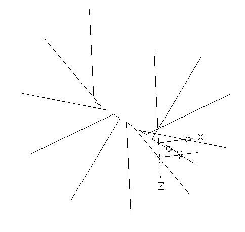

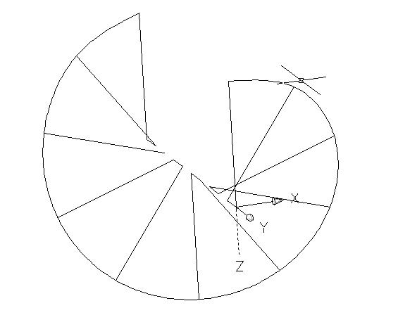

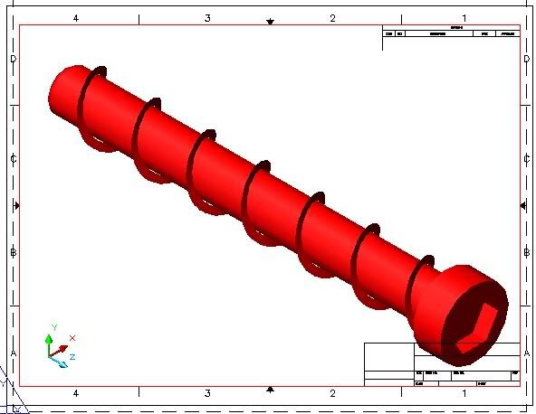

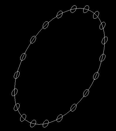

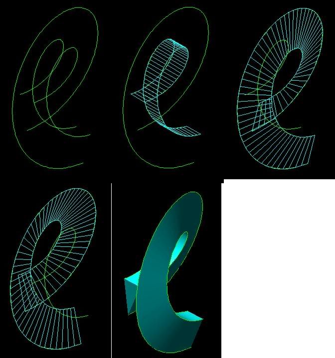

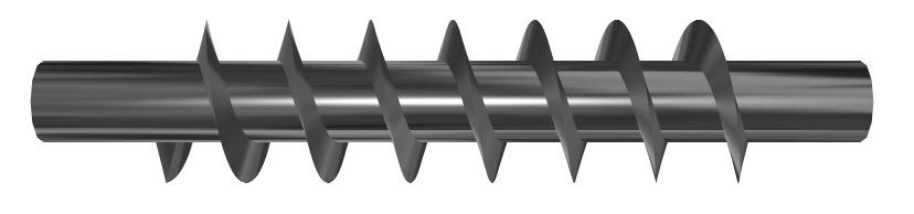

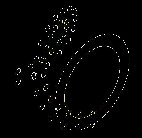

SilverTiger Posted November 29, 2008 Posted November 29, 2008 Possible solution. Here's a walkthrough of a bolt I created. (It's a step-by-step, I know, but I like to be thorough nonetheless.) Create a circle and divide it 20 times. Array your circle down the Z axis (or whatever axis runs perpendicular to center) 21 times and move your nodes to each circle accordingly; your first node (which should not have been moved) will be copied to the same exact postion on the 21st circle to restart the pattern. Create another layer and offset you first circle whatever the width of your thread is going to be and divide it 20 times. Repeat the same process and move the nodes to their respective positions on each circle, following up with your first node as your last on the 21st circle. Erase all circles except the first two. (Use them as reference points, and then later on extrude the inner circle into a bolt or pipe.) Create another layer and draw a spline on each set of nodes. Set the surftab system variable to 64 - Command: surftab1 Enter new value fo SURFTAB1 : 64 Now create a ruled surface using the splines as your edges Now you can copy your thread end to end as many times as you want and make you pipe or your bolt or whatever. I hope this is what you were looking for. But of course, this is only a 2d representation of the thead. To actually give another dimension, you have to copy the interior spline to both sides of the exterior spline. This is the top view. To the left is the original two splines. The larger is the outer, and the smaller is the inner. To the right, I have copied the inner spline .125 units in both directions on the Y axis. Then I drew 3 ruled surfaces to connect all of my edges... End Result: Quote
-TJ Posted December 1, 2008 Author Posted December 1, 2008 SilverTiger, wow thanks! I'll have to try that out. I had mild success modeling the leadscrew by drawing & extruding each lead (each along it's own helix) and then subtracting them all from a cylinder. The model still takes more than a couple minutes to load now, but once it's up all is well. Seemed like the harder way to go about it rather than my first effort where I simply had drawn a cross section of the lead & tried to extrude/twist it. Quote
fuccaro Posted December 1, 2008 Posted December 1, 2008 SiverTiger: wow! nice end result! TJ: try the Helsurf lisp. It is somewhere here: http://www.cadtutor.net/forum/showthread.php?t=78 Quote

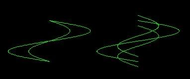

shift1313 Posted December 1, 2008 Posted December 1, 2008 in acad 05 i modeled a thread just like silvertiger showed here. Its a very effective method. although i didnt use circles. i just drew a vertical line, did an array for the number of segments i wanted for my thread pitch for say 1". then i did a line back in the Z direction, re-oriented my ucs and did an array of this line. This line in the z will be the location of each line segment from the first part. the amount of lines you use will determine your resolution. I think i did an array of 30 lines in the first step and each variation back in the Z direction was like .01".(cant remember the exact numbers i used). Quote
SilverTiger Posted December 2, 2008 Posted December 2, 2008 I'll have to try that sometime. Anyway, I read TJ's post and figured I could give it a try - it was my first time modelling a screw, so I had to figure it out along the way. Glad I could be of some help to you TJ. Quote
shift1313 Posted December 2, 2008 Posted December 2, 2008 here are a few screen shots i just made. Quote
