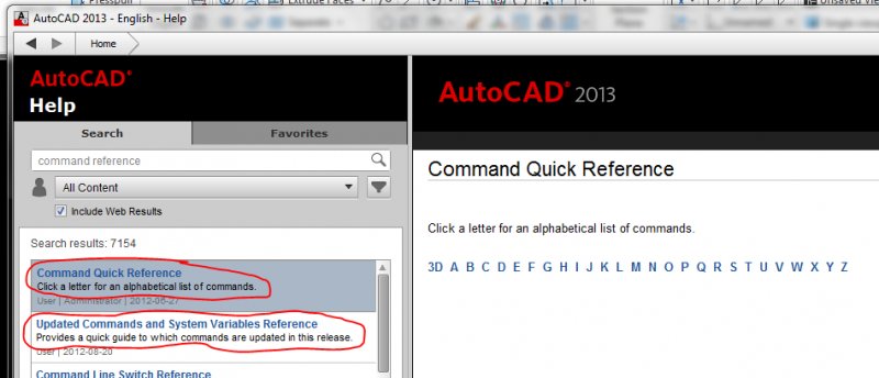

ReMark Posted July 18, 2013 Posted July 18, 2013 I guess you failed to look in AutoCAD's Help file. Seek and ye shall find. Quote

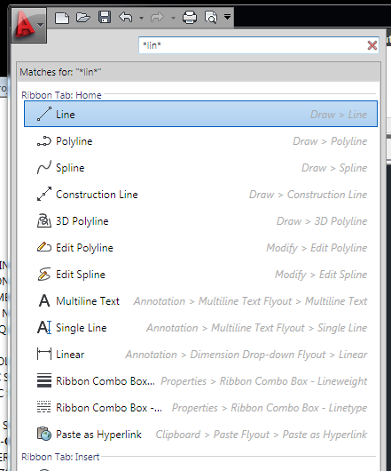

nestly Posted July 18, 2013 Posted July 18, 2013 The AutoCAD search tool is pretty powerful if you don't know exactly what you're looking for. (notice that the middle word in the command description is skipped, and the result is shown with only two letters of the 2nd word.) This also happens at the command line in 2014. Quote
ReMark Posted July 18, 2013 Posted July 18, 2013 Is the predictive search feature available in 2011 (what the OP is using)? Quote
tzframpton Posted July 18, 2013 Posted July 18, 2013 It works in 2011. Just tested. *EDIT* nestly beat me to it. *EDIT #2* Also, you can use Wildcard Matches.... so type *LIN* will get you anything with the letter LIN in the command. This can be useful in discovering new commands as well as finding that one command you can't remember all the way. Quote
