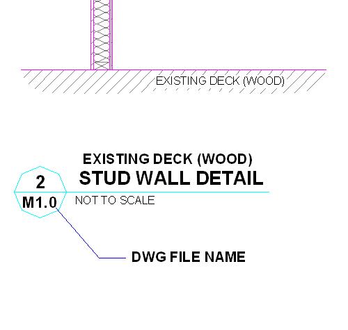

I’m always looking for custom programs. One thing is a little time consuming is insert ID bubble and title blocks.
Can an attribute that is in a block be inserted into a DWG file that one of the value’s change to match the Dwg name?
Example.
Creating Mechanical detail sheets. Insert ID bubble’s into Dwg file and bottom number “Value” change to match drawing number?
But to be able to modified if needed!
It would be great if the top value were automated to change to the next number and the bottom number “Value” would change to the DWG file.
I would like to do the same thing with a title block? Insert title block and the File No value change and the drawn by Value change to the user initials.
Can any one help?

totally doable. I have VBA code for both if your interested
It seems no need programming. Create block with attribute and change it to field:
Simply paste blue text to attribute value. It will always show your filename.

what is your block name and tag name, and I will put together a short routine to test
Block name "DT-IDLABEL" and tag name "DNO#".
Here you go, tested and it works. It will fix all of the blocks named DT-IDLABEL in a drawing to reflect the drawing name
