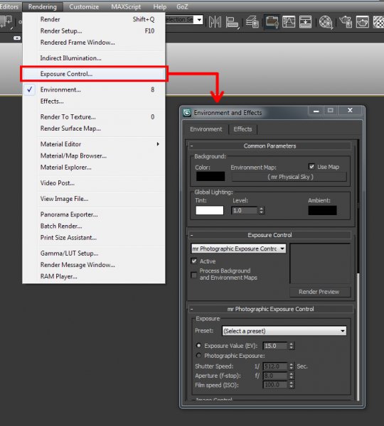

Attached is an import from Revit... I exported a model as an FBX and it imported wonderfully. Even grabbed cameras, photometric lights, etc. Can someone look at my Sun Properties and see if I have some discrepancies? When I render, it comes out all white with few speckles so I assume my exposure control is off, or too much brightness on my light source.

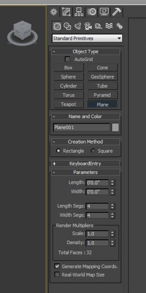

Also, what's a good way to add a plane? Just add a rectangle and apply a material to it?

Open up your Environment and Effects dialog and make sure your "Exposure Control" is set to "mr Photographic" and your "Exposure Value" is somewhere between 14 to 15.
To add a plane, just go to your "Object Type" rollout and add a Standard Primitive "Plane".
Perfect!! Man I would have never found that one. Thanks for the tip... I'll look into reading up more about this option. So far the render turned out great. This now officially gets me excited to jump into 3ds for all rendering purposes.

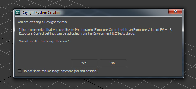

Just make sure, whenever you're creating a daylight system, always answer "Yes" to the pop-up message. If you answer yes, your exposure settings will be set automatically. If you answer "No", your exposure control will be set to "No exposure control" and you will have to manually set your preferences in the "Environment and Effects" dialog.
