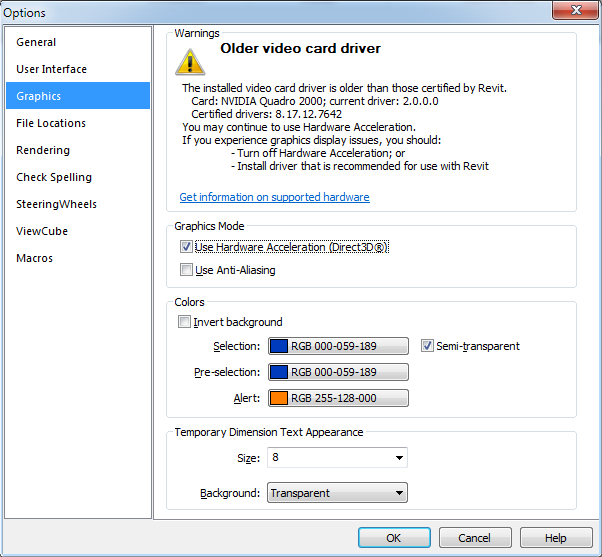

Tanner, does Revit work well with a GeForce card? We are due 1 machine coming up and I am looking at a high end graphics machine instead of a work station.
First choice: Xeon. Second choice: i7.
If money is not option then I agree. Now if there is a budget then it depends on what the budget is. I have found that the low-end Xeon to not be worth the money myself. My work machine was about $2k new and I compared it to a 6 - 8 month newer PC and it beat it on most of the criteria. Xeon cpus are expensive and so is the ECC ram that goes with it.
I think one has to weigh the budget with what you can buy.
Most certainly. Revit utilizes Microsoft's DirectX driver so performance between workstation level cards and gaming cards are neck and neck. See here for an example:
