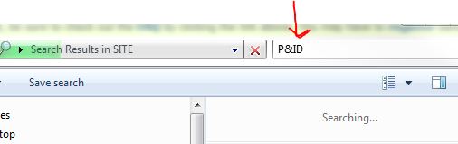

Sengna Posted September 4, 2013 Posted September 4, 2013 Does anybody know how to search for keywords within autocad file? word in title block, I got alot of DWG files inside the Hard drive, my co worker was asking me to plot out one of the drawing, don't know the drawing number but only know the date/mo/years was created, and the words inside the file. i typed in the window explorer as shown below but found none. sometime it's very difficult to look for the certain drawing when someone named by number and letter, i like to name the cad drawing with good description and then i put the dwg # or Pro# in the title block. Quote

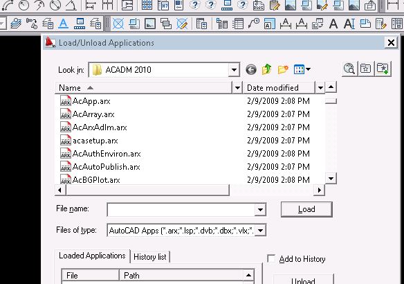

Sengna Posted September 4, 2013 Author Posted September 4, 2013 As is usually the case, Lee Mac can help you do that,with one his wonderful lisps, very generously made available free of charge on his website. Thanks Lee! http://www.lee-mac.com/bfind.html Use the SEARCH ONLY option. . :} I tried to load the LSP file on my system, i follow Method 1 on his web (using upload), in Autocad i typed in Appload but i can't find the (Mylisp.lsp) i don't know how to get that extension (www.lee-mac.com/runlisp.html). How can i get it? should i get from the original CD. Quote
Sengna Posted September 4, 2013 Author Posted September 4, 2013 on his web, on Method 1 it shows MYLISPs folder, but my doesn't have it. Quote
Dadgad Posted September 4, 2013 Posted September 4, 2013 You need to download the lisp from Lee's site and remember where you put it on your computer. Then you can browse to wherever you saved it, and load it from there. The dialog box shown in your last post will enable you to browse to, and load it. The lisp you want to load will be named BFIND (for Batch Find). It won't already be on your computer, you need to download it first, if you haven't already. If you are uncomfortable loading and using a new lisp, might there be someone else who can help you with it? Quote
Sengna Posted September 4, 2013 Author Posted September 4, 2013 You need to download the lisp from Lee's site and remember where you put it on your computer.Then you can browse to wherever you saved it, and load it from there. The dialog box shown in your last post will enable you to browse to, and load it. The lisp you want to load will be named BFIND (for Batch Find). It won't already be on your computer, you need to download it first, if you haven't already. If you are uncomfortable loading and using a new lisp, might there be someone else who can help you with it? Okay, i see, i guess i have to contact my IT to buy it or something if they have them for sale. i saw one tutorial on youtube where he showed how to import LIsp from CUI. i tried it didn't work. Thanks Quote

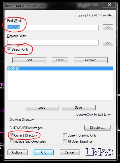

ReMark Posted September 4, 2013 Posted September 4, 2013 I tested Lee Mac's lisp routine using a date as my search criteria and I am happy to report that it worked. I downloaded his routine to my desktop then opened one of my drawings. I used APPLOAD to load the routine. All I had to do was to navigate to the place on my hard drive where the file was stored. This is a simple and straightforward procedure using the "Look in:" feature at the top of the Load/Unload Applications dialog box. Once the lisp file is located I used the "Load" button. Immediately after the program is loaded looking at the command line I am told to type BFind to run the program. Once again...very easy. When BFind is run a dialog window will appear and that is where your search criteria is entered (just as it is shown at Lee Mac's website). See the attached image below to view exactly what my search criteria was. My test was conducted using a directory that contained only five drawings so the search did not take very long. Try to narrow down your search as much as possible to save on time. Don't just do a search of your entire C: drive as it may take a very long time to get back the results. Quote

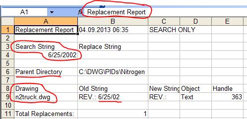

ReMark Posted September 4, 2013 Posted September 4, 2013 The result of the search is an Excel spreadsheet called Replacement Report. As you can see my search resulted in the finding of one file with the date I specified in my search. Quote

Dana W Posted September 4, 2013 Posted September 4, 2013 EDIT: Sorry, ReMark already went over this one, but just in case you missed his post (I did), I will leave mine here. on his web, on Method 1 it shows MYLISPs folder, but my doesn't have it.OK, take a deep breath, exhale slowly. MYLISP is Lee's (and everyone else's) way of telling you to use the folder name where you saved the lisp program. He could have called it anything. It doesn't exist yet. MYLISP = ANY folder on your computer that you decide to save the downloaded lisp in. Before you download the lisp, create a folder and name it something, anything. You can name it MYLISP if you like, then save the lisp in it. Quote

ReMark Posted September 4, 2013 Posted September 4, 2013 Since you are using Windows 7 you can use Windows Explorer to do the search and if you want one of the criteria can be the date. However, you'll have a quicker time of it if you can narrow the search down to a particular building. Obviously, there will be no report as with Lee Mac's lisp routine. BTW...I tested this using a date and it does work. If you still have trouble finding the right drawing you may have to go from a simple search to one that is more advanced in which case refer to this article by Microsoft re: "Advanced tips for searching in Windows." http://windows.microsoft.com/en-us/windows7/advanced-tips-for-searching-in-windows Quote
