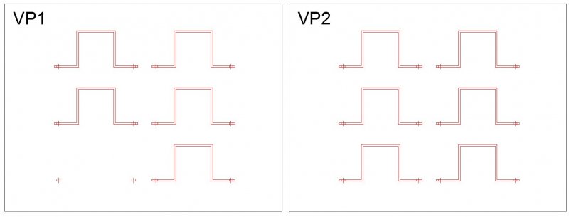

ReMark Posted October 3, 2013 Share Posted October 3, 2013 (edited) Don't leave yet. I think I found another lisp routine that will hide objects in individual viewports. Having mixed results. Sometimes I can get it to work and sometimes I can't. Requires making object(s) invisible first where they disappear from all viewports. Then going to the viewport where we want them to be shown and making them visible. If they don't immediately appear a REGEN, while still inside the viewport, is invoked and the object(s) reappears. Two viewports showing the same six objects. What's missing? All objects on same layer. No new layers created. Edited October 3, 2013 by SLW210 No need for multiple posts Quote Link to comment Share on other sites More sharing options...

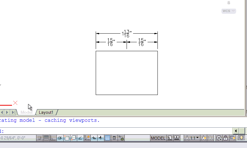

nestly Posted October 3, 2013 Share Posted October 3, 2013 Annotative dimensions are perfect for this type of situation. If the Viewports are different scales, each dimension has only 1 scale. If the Viewports are the SAME scale, make a copy of the scale and assign that scale to objects that are supposed to be displayed in both Viewports Quote Link to comment Share on other sites More sharing options...
tzframpton Posted October 5, 2013 Share Posted October 5, 2013 If I don't want to VP Freeze everything on that layer, is there a way to individually VP Freeze certain objects on one layer? (without having to make new layers?) The sitch: Making a ceiling plan, some dims are needed in all the other plans, but some are not needed in the ceiling plan. How can I simply turn "off" in the VP the few separate Dims I don't need? And that they can still turn up like normal in all the other VPs? Bad part is AutoCAD doesn't behave in this manner. Good part is, since you're dealing with dimensions, they are annotative which can in fact have this functionality. Nestly's demonstration is exactly how you would accomplish this. Granted, it's a workaround and it nests you further down the rabbit hole, but it can be done no problem. The functionality you're inquiring about is a native functionality of Revit, which is a great platform you may want to look into. Granted, this one particular inquiry of yours doesn't warrant switching platforms, but I promote Revit when I can for anybody doing building design because of the overall benefits. Quote Link to comment Share on other sites More sharing options...
