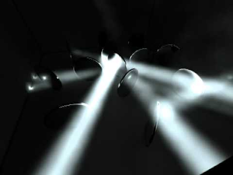

I am using Mental Ray in Max 2014, trying to recreate this effect and test other caustic effects:
I am relatively new to using photons, but as far as I've gotten is setting up the scene with the following objects: A box->shell interior as the set area, a few objects with mr A&D glass (physical), a light, and a plane in front of the light with a mental ray material applied (transmat photon in the photon slot as shown and seen in the description of the youtube vid here).

I am looking into the use of parti volume but it does not seem to suit the examples, if anyone knows some tricks using the photon and photon volume channels of a mental ray material I think I need some tips. The example linked above talks about a plane in front of the light with a material that will somehow convert the photons to light volume beyond it. Maybe something changed since then, but I cannot reproduce it.

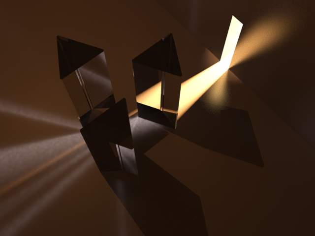

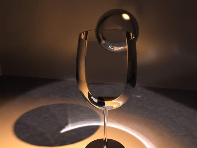

This is with a photometric spotlight, I had caustics on with a x20 multiplier, and the light was set to 1 million energy and caustic photons, with 20k of GI. Final gather was on. 100W bulb template with adv. raytrace shadows. Took 2 minutes to process all.
I put the same light from above in a slot in the wall and narrowed the field/falloff, doubled the caustic photons. Added a 3 cd area light to the room with a little bit of GI. Process and render time 5 minutes. Can see the color of the light does not pick up after the first refraction. Still trying to get the volume effect so I'll try adding parti volume to the light.
