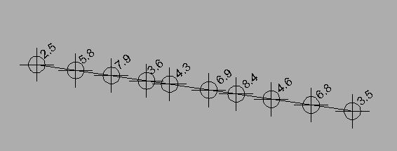

Hi,
I am wondering if there is any lisp to align set of selected points with a line. Actually the points have XYZ value. The value should not be change.
Input: ----
Output: ---

actually the points are cross section level of a river. and the river is arround 30 km long. I have to create cross section at an interval of 200 meter. I captured only one level line. The point have true Z value and that true value is annotated. That's why the annotated Z value should not change.

Change your ucs so that x runs parallel to the line and the ucs is on the line, which means y=0 then select all the points and in the properties palette change the y value of the points to 0
Try this...
