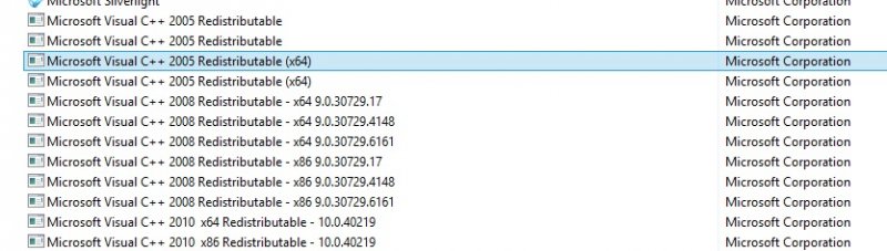

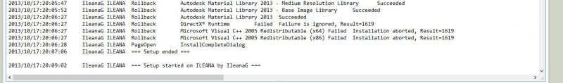

igreere Posted October 17, 2013 Share Posted October 17, 2013 Hello. As the title says, I get the following error when installing 3ds max. The screen looks like this: . I read on the Autodesk site that I need to uninstall Microsoft Visual C++ 2005 Redistributable, only that I have 4 such programs in the programs list and then Miscrosoft Visual C++ 2008 also. I do not know which to uninstall and I am afraid to do any harm. I do have AutoCAD 2010 and AutoCAD Architecture 2012 installed on my machine also. Does anybody have a clue? Thank you. Quote Link to comment Share on other sites More sharing options...
