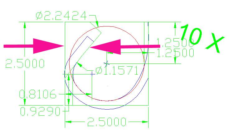

gotchy Posted October 20, 2013 Share Posted October 20, 2013 Will someone please tell me why after selecting Dimension, Angular, then selecting two lines, I do not get the angle between them? I am using v 2000 if it matters. I enclose a screen shot of the two lines I need the angle of. Thank you, gotchy Quote Link to comment Share on other sites More sharing options...
Dana W Posted October 21, 2013 Share Posted October 21, 2013 Some of these might be your issue. Both lines have to be in the same work space, paper or model. Make sure the lines are co-planar, on the same plane, equal z values at both ends of both lines. Is that green line a dimension extension line? If so, that won't work. A work around would be to just draw an extra line on top of the one that is failing. Quote Link to comment Share on other sites More sharing options...

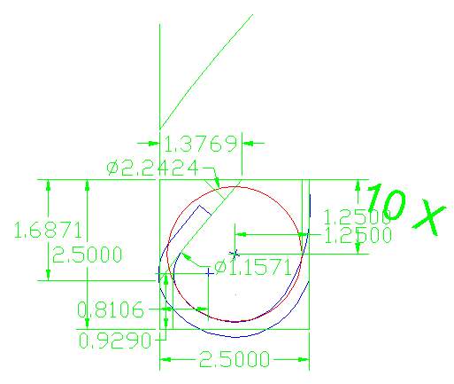

gotchy Posted October 21, 2013 Author Share Posted October 21, 2013 Thank you all for your response. Actually I did try the work-around with negative results. I am wondering if maybe this is a bug in my software and maybe needs a re-installation? I enclose a screen-grab of the attempt. gotchy Quote Link to comment Share on other sites More sharing options...
ReMark Posted October 21, 2013 Share Posted October 21, 2013 The "bug" is not in your software. Do NOT uninstall / reinstall the software. Attach a copy of the drawing file to your next post. Quote Link to comment Share on other sites More sharing options...
Dana W Posted October 21, 2013 Share Posted October 21, 2013 Thank you all for your response.Actually I did try the work-around with negative results. I am wondering if maybe this is a bug in my software and maybe needs a re-installation? I enclose a screen-grab of the attempt. gotchy Those dimensions are pretty large scale for the area you are working in. I think your cursor is just not finding the line. It may be getting a snap from somewhere else close by, or it can't find anything but extension lines in that tight space. So you found all the conditions in post #2 to be OK? Remark is right. Uninstalling and re-installing would be like repainting a brand new car when the tire pressure is low. Quote Link to comment Share on other sites More sharing options...

continentalkev Posted April 20, 2023 Share Posted April 20, 2023 I discovered another cause of the same problem. I was working on a drawing exported from Inventor, and Inventor often turns simple lines into splines. It had done that with one of the lines I was using to dimension an angle. AutoCAD wouldn't dimension an angle between a line and a spline, but didn't show any error to help identify the problem. The fix was just to draw a line over the spline, and delete the spline. Quote Link to comment Share on other sites More sharing options...
